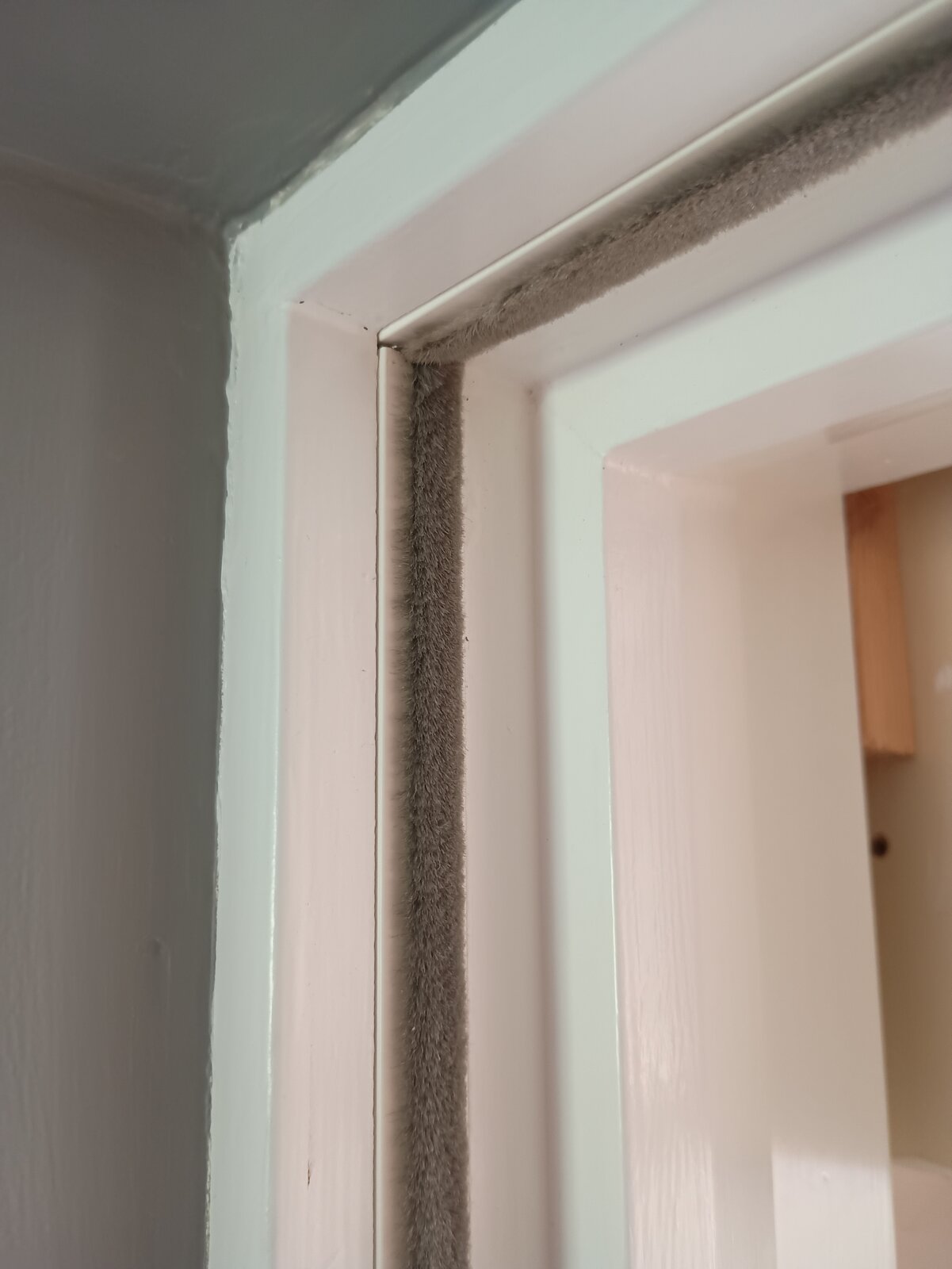

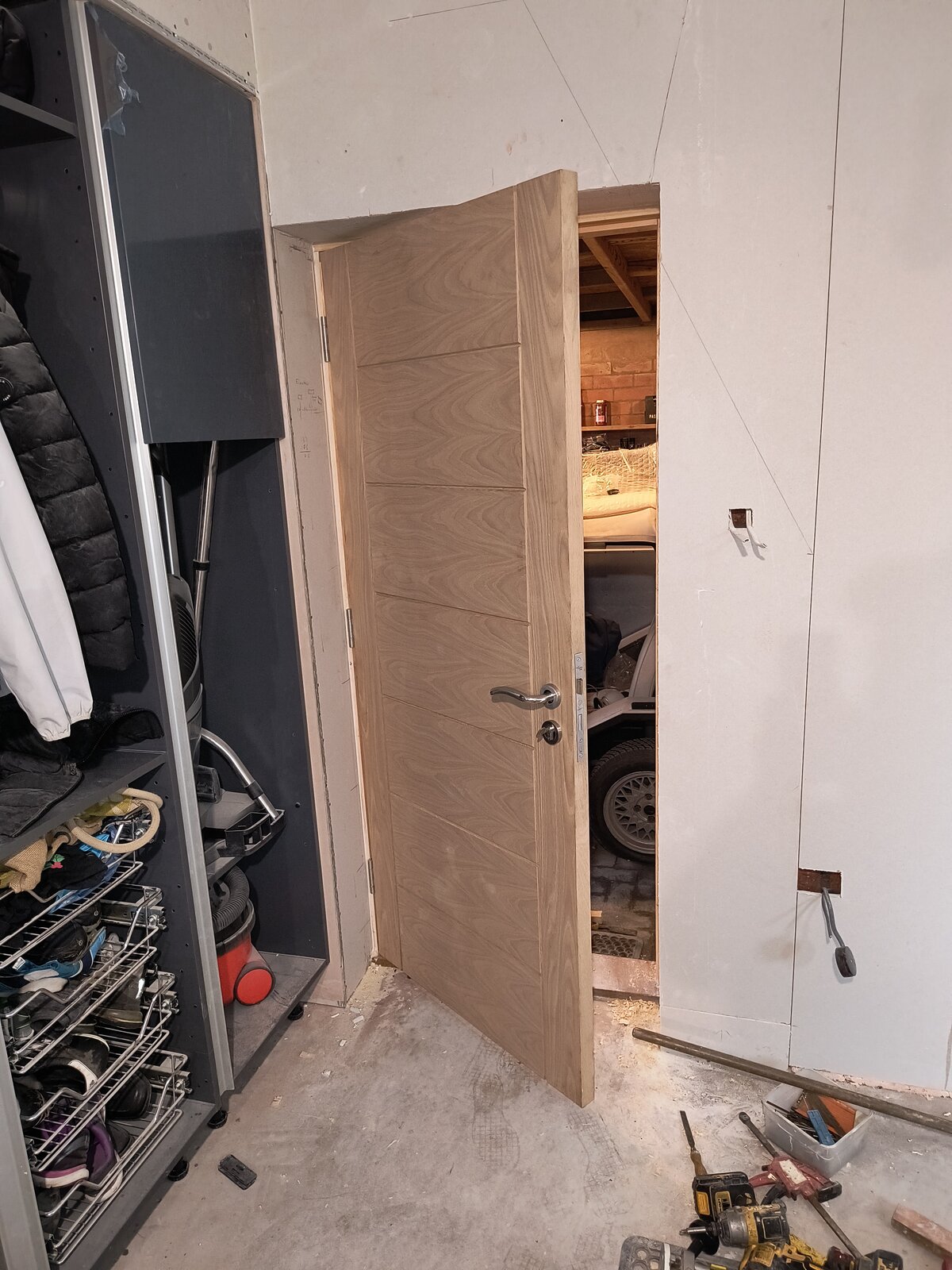

A fire door frame should have a groove into which the intumescent strip should be fitted. This swells when it gets hot and fills the gap. You can optionally buy them with a brush included, which provides draughtproofing while the place isn't on fire.
See attached photo of mine.
If you haven't got a strip then it's not a fire door. It also needs a spring to close it.

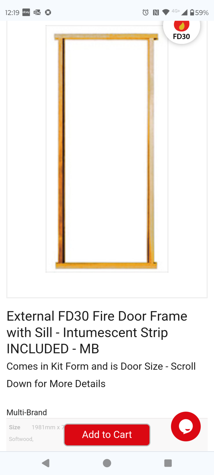

Fire doors don't have sills. The casing or frame should have a 15mm wide trench for the fire AND smoke intumescent seals to fit into.

The brush is not an option for garage - dwelling, it's compulsory.
Makes sense for compulsory draughtproofing for garages - petrol vapour and/or fumes.
And it blocks smoke before the door catches fire.
A pretty good idea anyway, keeping fumes out of the home after you've reversed the car in.

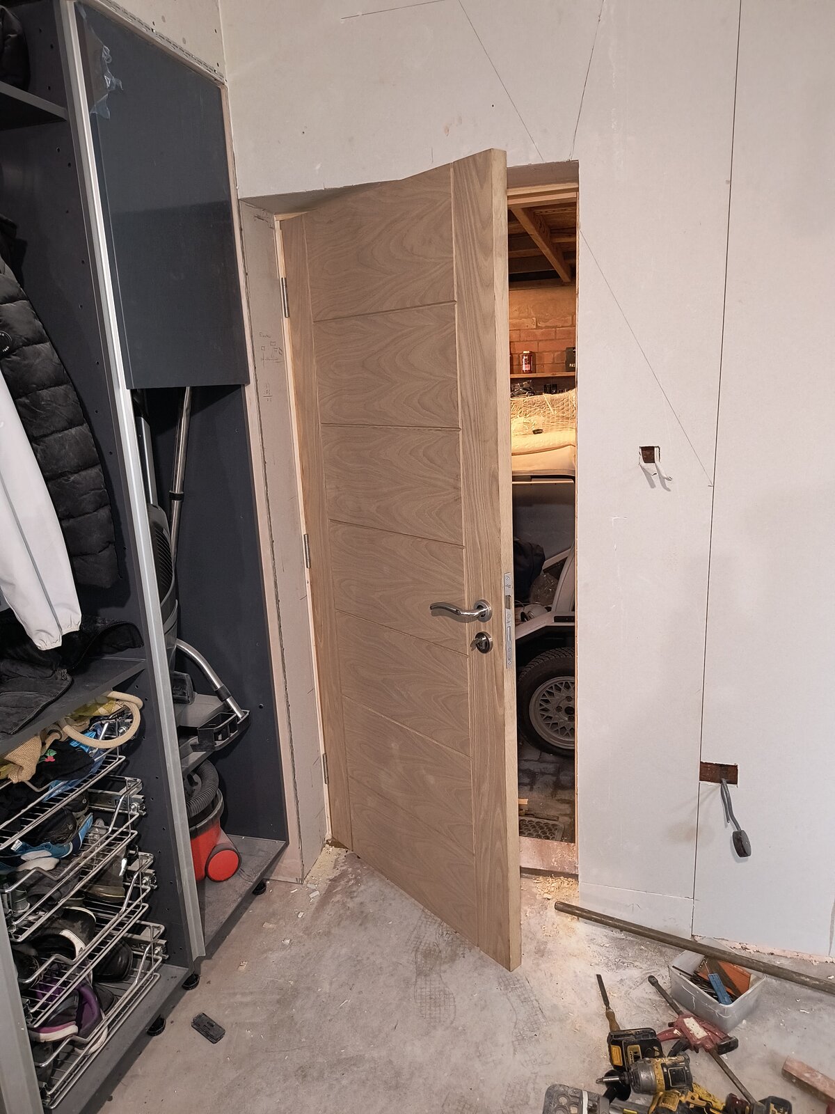

Give me a chance guys, I only put the bloody door door on yesterday - things move slowly here. Groove is ready for the fire and smoke strip and it and the closer (proper one, not a slamming chain thing) are on order.
I'm not sure how the bottom is generally dealt with - I assume it's a case that smoke rises.

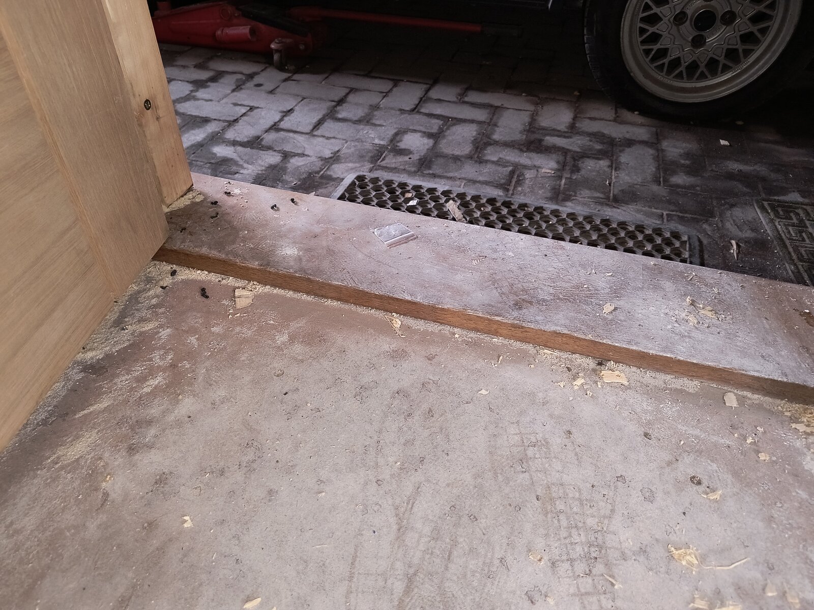

Made my own threshold because I don't quite know my new FFH and didn't want to be planing the bottom off, but you can buy them (£157 at this place!!!)
You'll find it hard to close after you fit the brush strip. Don't worry about it, it will settle in eventually.
