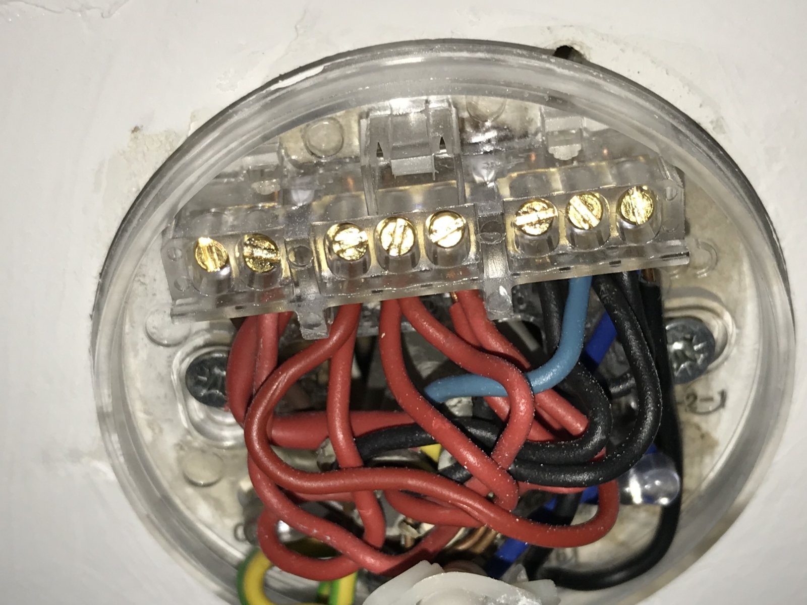

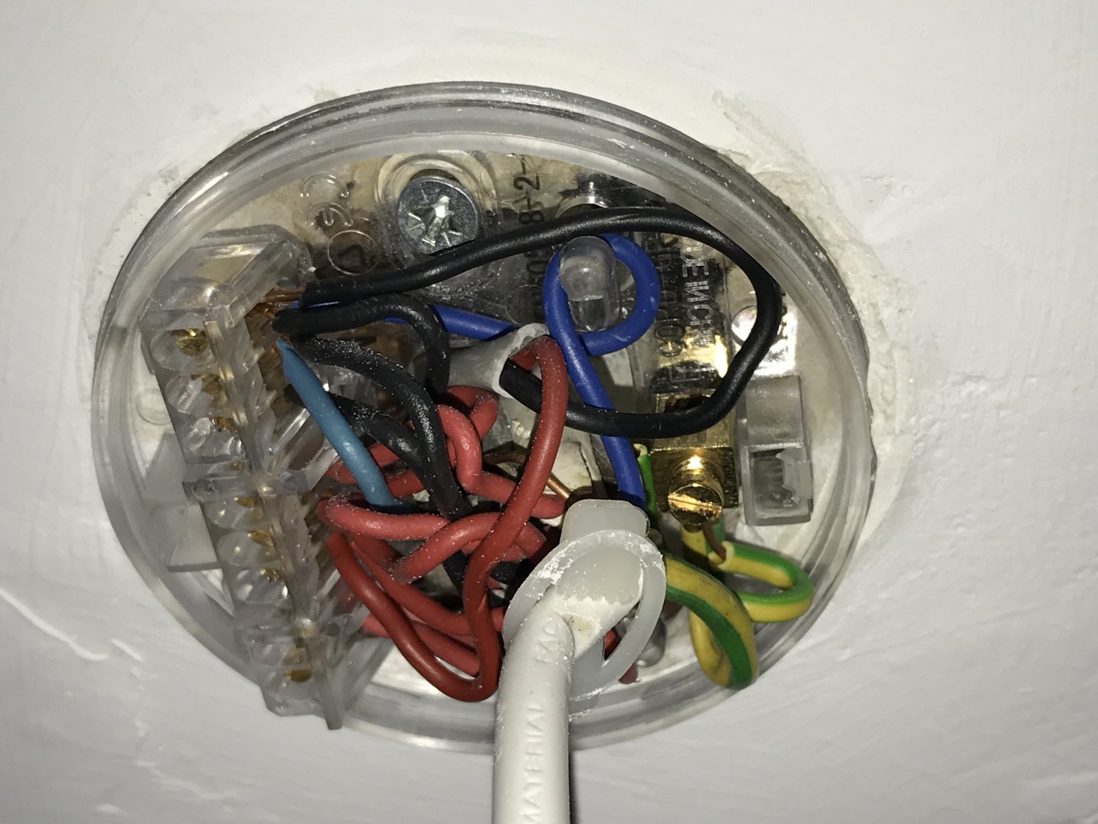

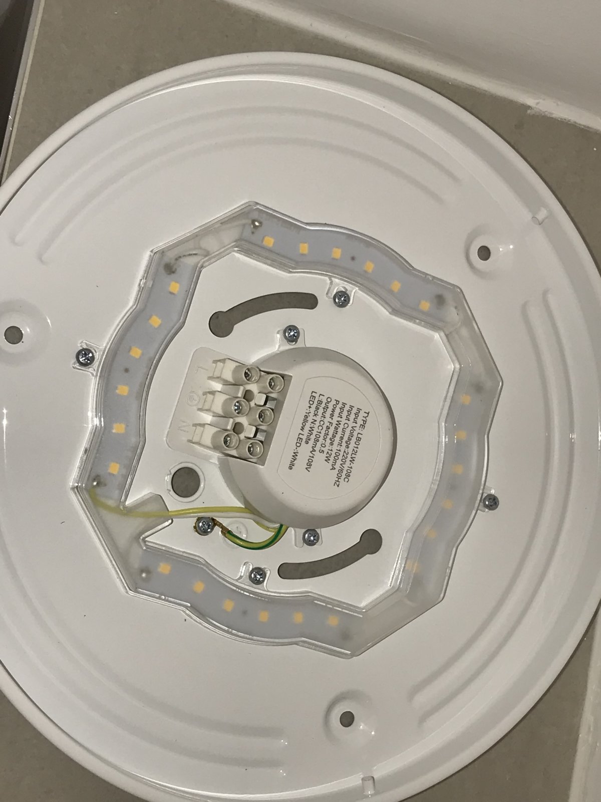

hi all, I want to change the ordinary pendant light in our kitchen to a flat LED light.
There are a few things coming off the ceiling rose (extractor fan, outside security light etc), so quite a few wires.
Can I just use Wago connectors and push them up into the hole in the ceiling, and then just have one cable coming through into the light?
If it was an upstairs light, I’d put a junction box in the loft just above and drop a cable down, but this is a downstairs light.
