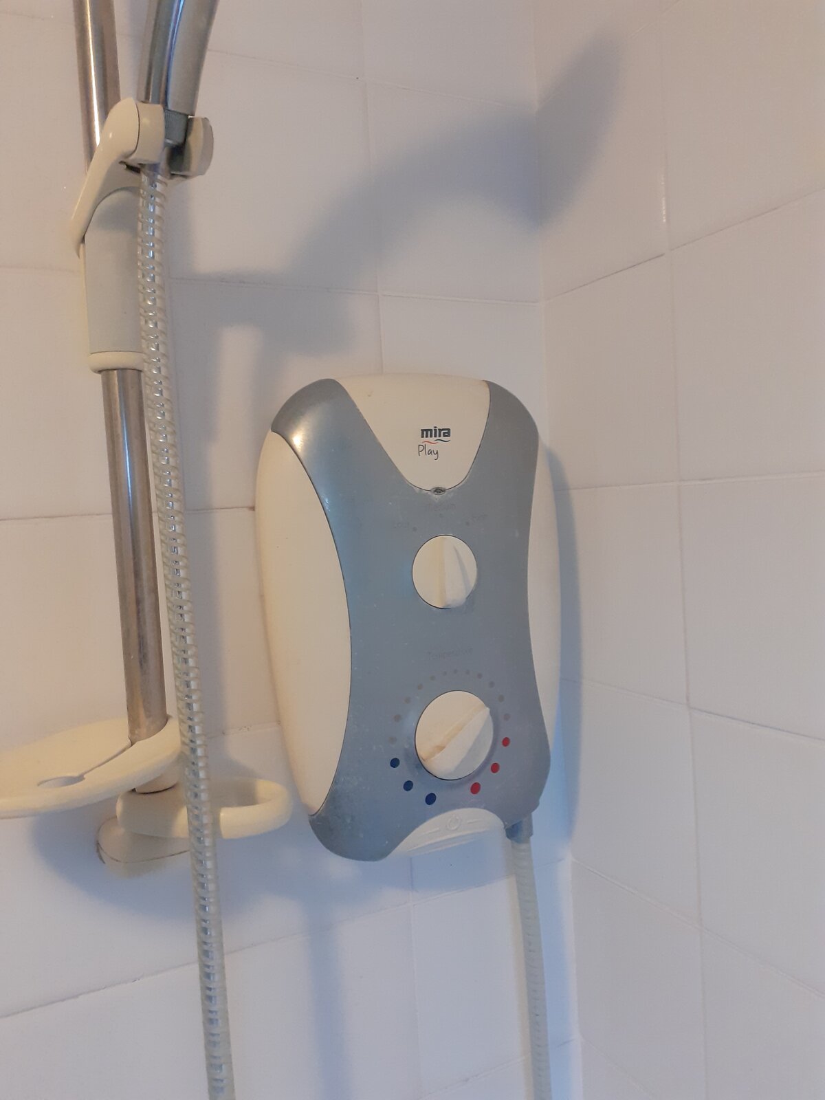

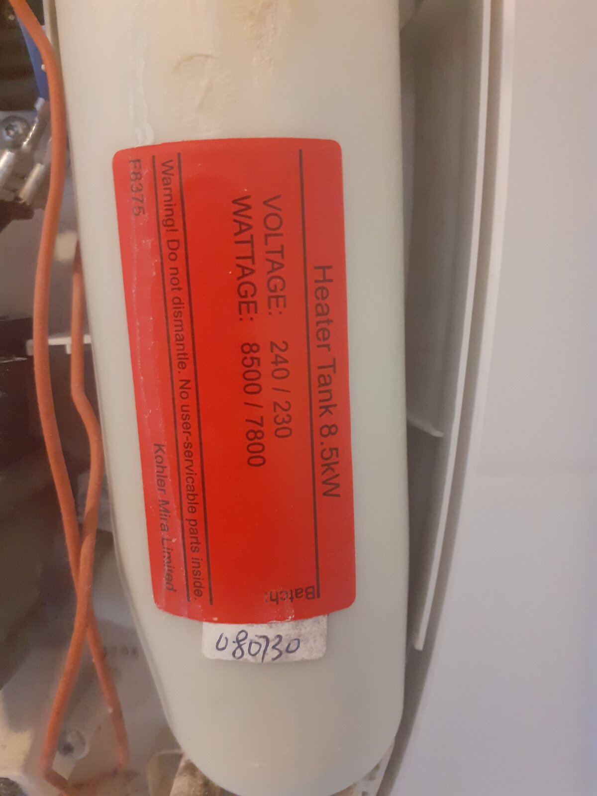

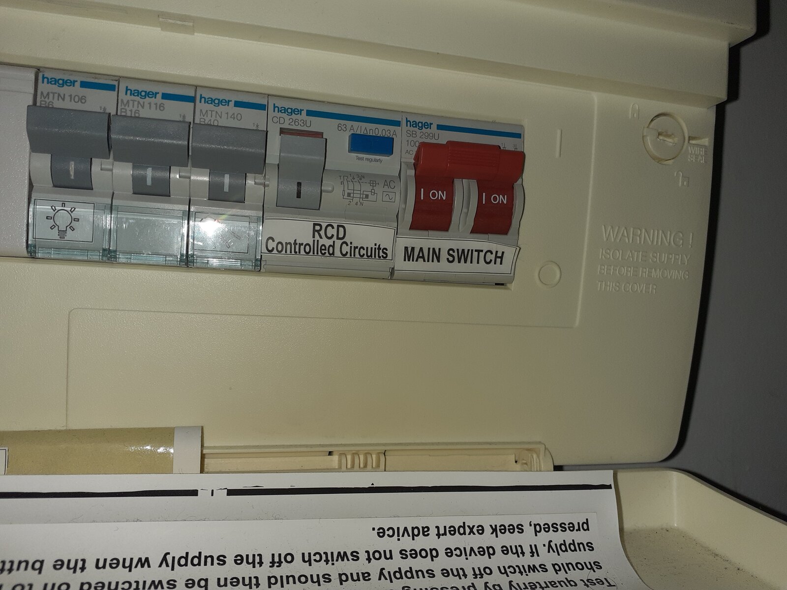

Wanna change this. Neighbour will help me. Which shower is recommended? Heard it's simple enough job
Triton T80, which can be had at Screwfix. Multiple options for the position of the water and electricity so will replace almost any shower.

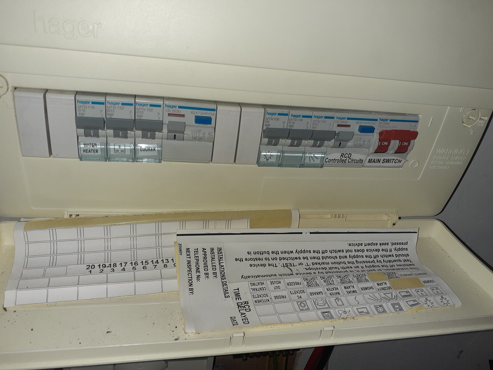

Before that - a picture of the consumer unit is required to confirm the circuit rating and whether an RCD is installed.

That is ok for a 9.5kW shower or below.
NOT suitable for anything above 9.5kW.
Screwfix have got Triton at 8.5 and 9.5kWh. £90.
Decided on Mira Sport 9.0 £160. Heard it's a better shower not 9.8.

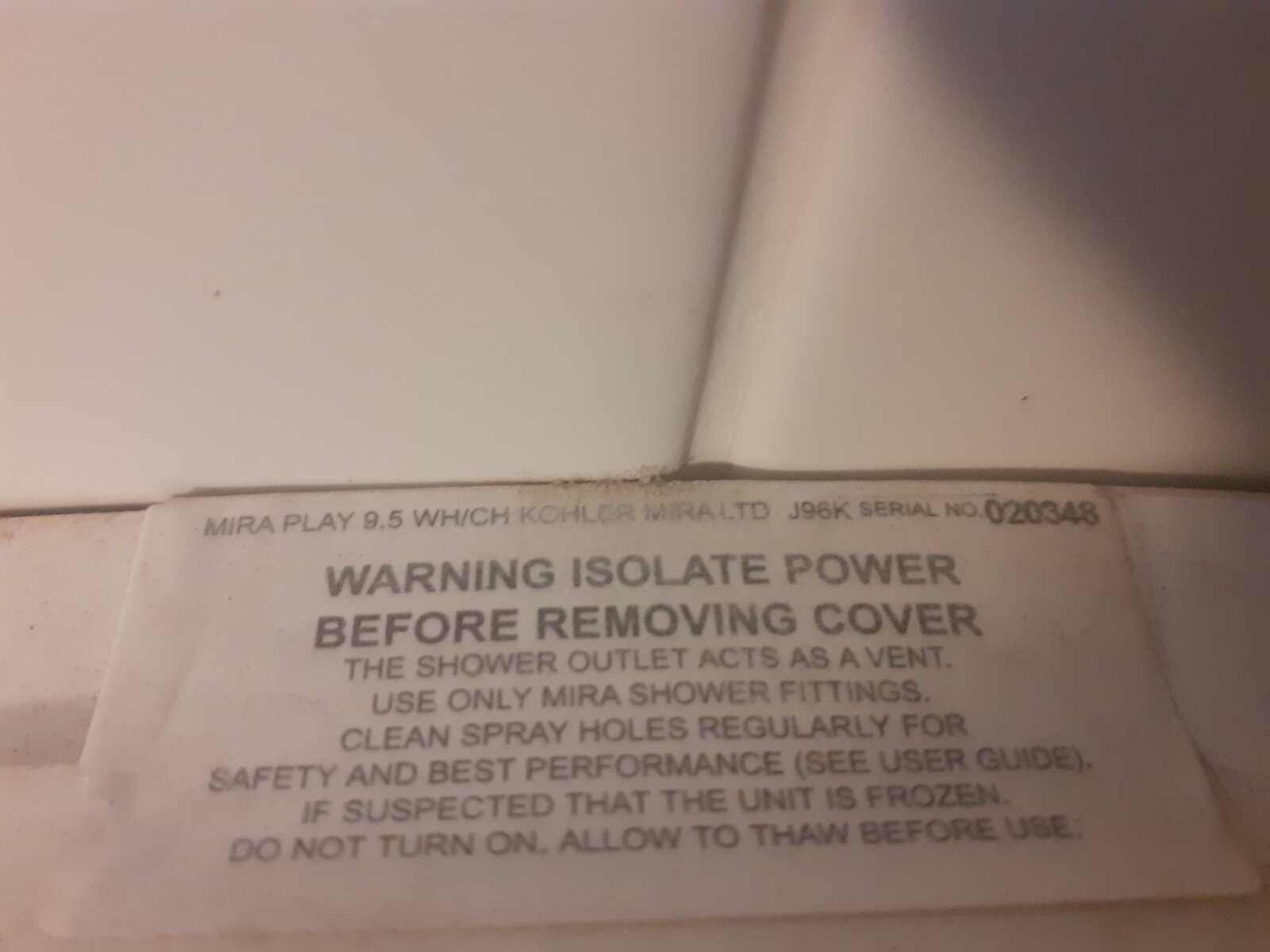

MIRA still make the Play so you can go like for like prob even still same screw holes
Shall i take this (sport)back and change for Play or will this fit?
