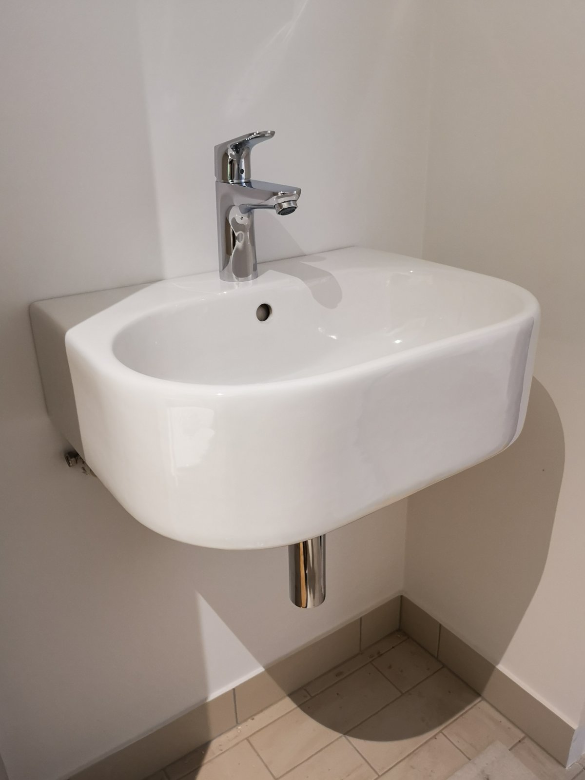

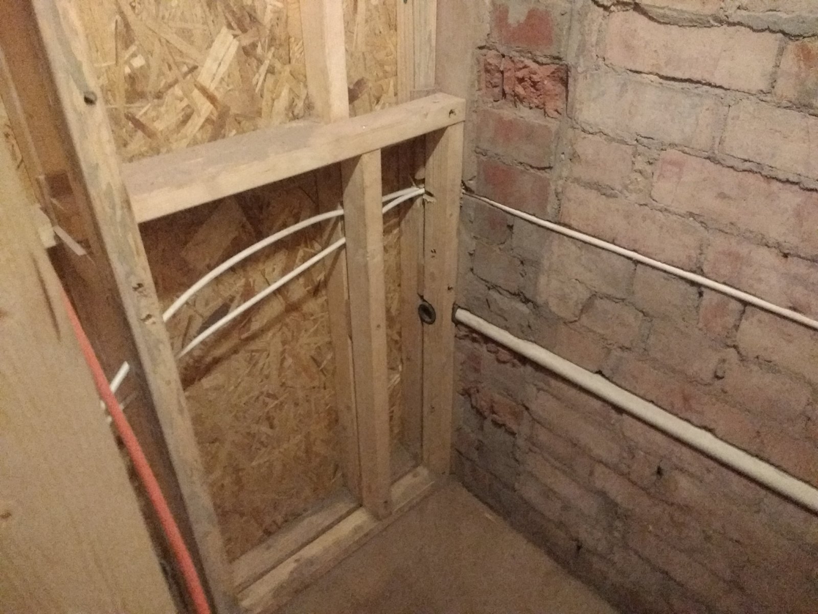

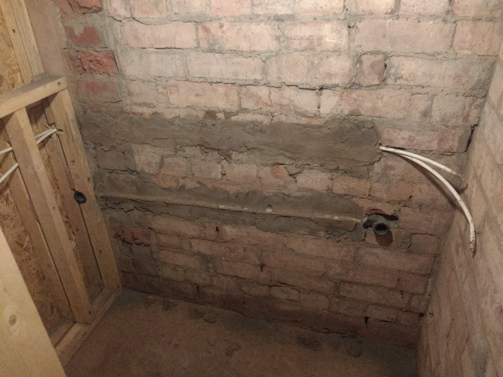

I've chased my 32mm basin wastes in, one vertical and one horizontal about a metre each. As the walls have been tiled the pipes only needed to finish flush with the finished plaster so about 20mm into the (hard) brick - but it's a messy, time consuming job - angle grinder, chain drilling, hammer and chisel to only go the minimum depth needed.
I've uncovered various old chases for 22mm heating and water pipes in my house which are so deep I could put a 40mm waste in with a bit of cleaning up.

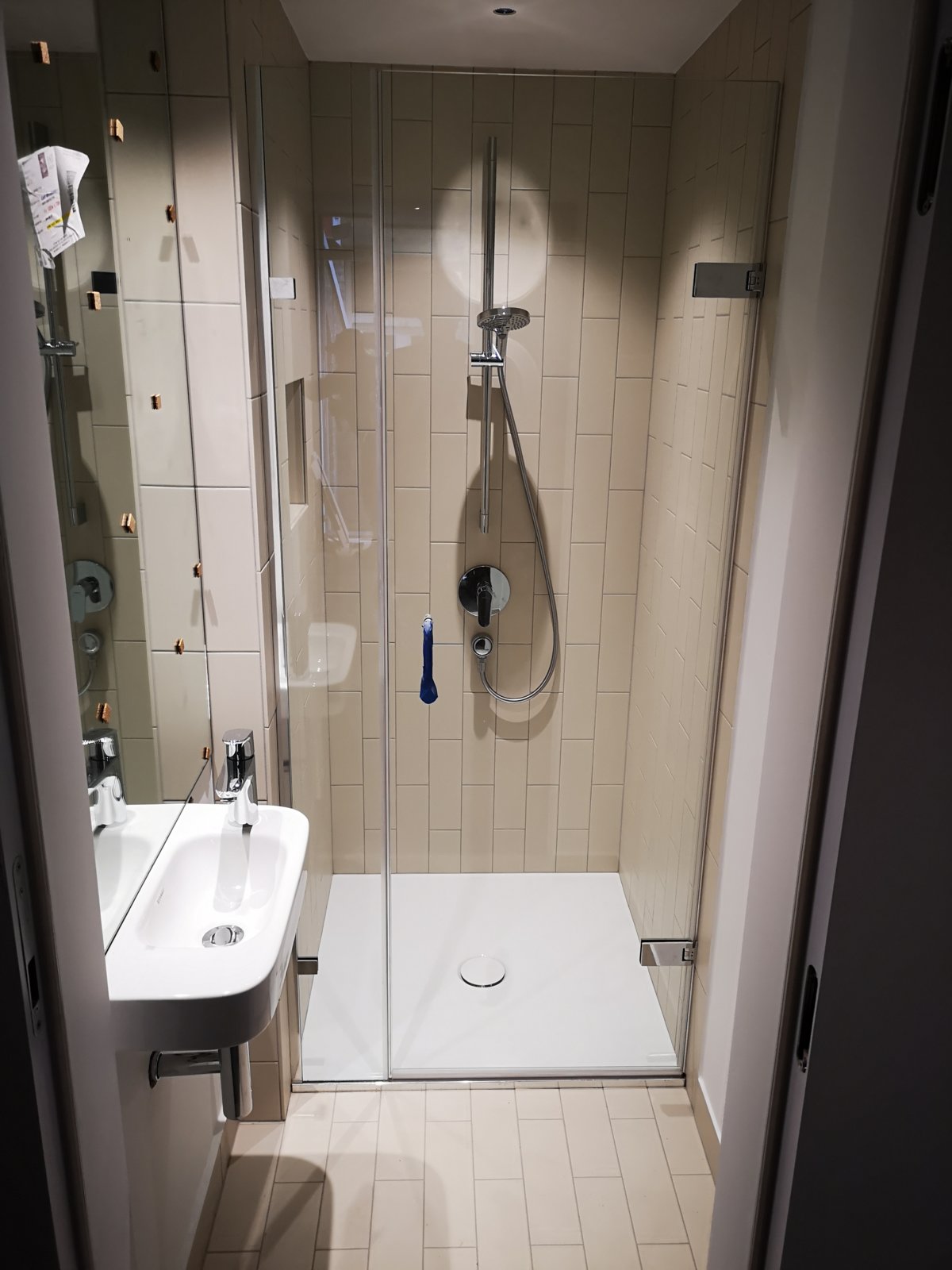

It's a garden flat in North London, which means it's in the basement at the front and has a garden at the rear... 3 stories above it, all soil renewed under the concrete floor and there are rodding access points where they need to be, and all discretely disguised.
It's at as much risk of leaking as anything else but is so short to not be of any concern to me :)

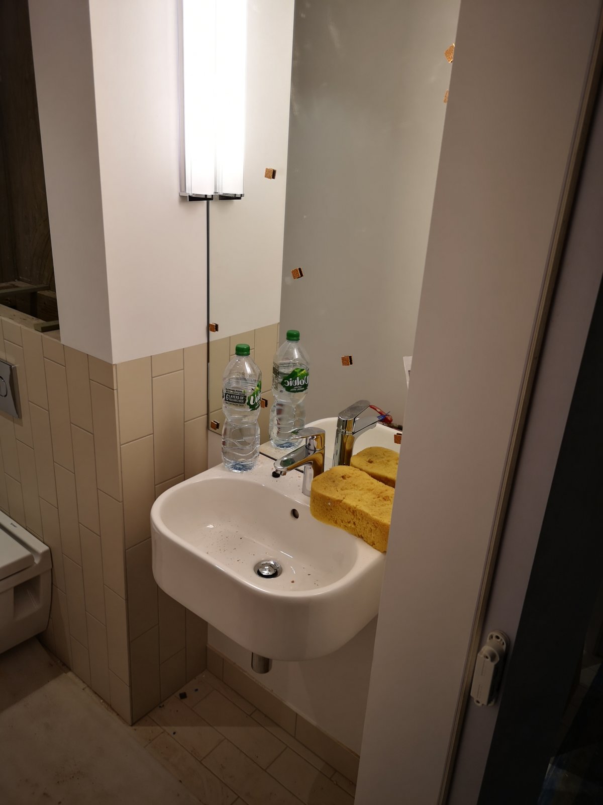

@dilalio thats precisely what I aspire to achieve. Looks great!

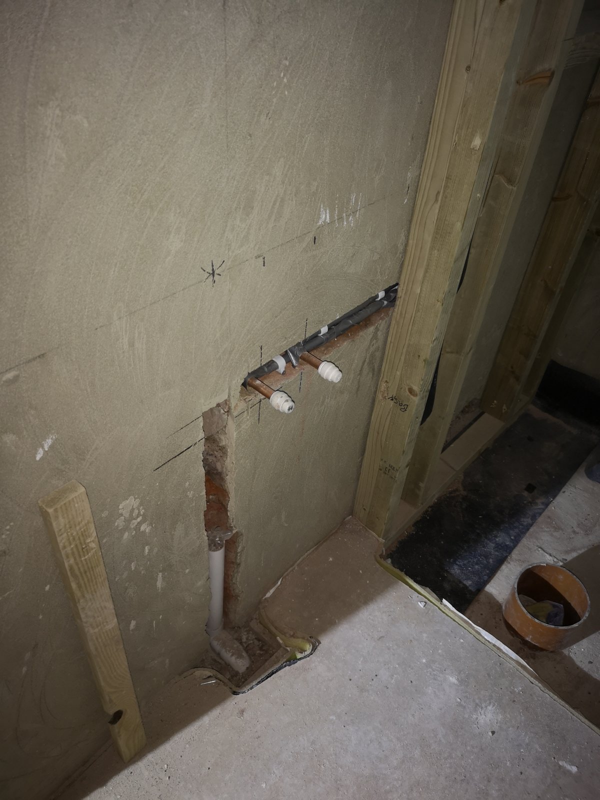

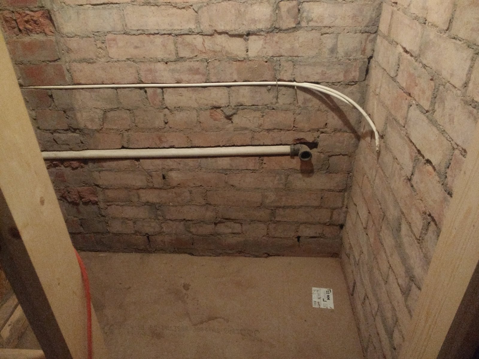

Presumably based on this and the pictures posted by @cdbe, my suggestion of a small vertical chase for the waste pipe isn’t that far fetched after all?
Looking good (y) @dilalio
@Jupiter01, at the end of the day, it's your shout. The link to the BC doc mentions the 1/3 depth, that's as per standards.
In real life we all know that standards are sometimes overkill and each instance is different and needs an educated onsite call. If you feel you are not compromising anything cutting into it, then no reason not to.
