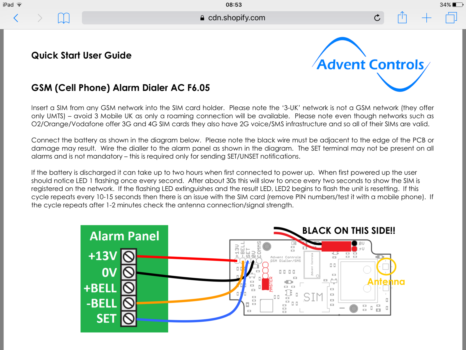

I’ve just fitted two of these, they work really well, work on a PAYG sim and can text up to 5 mobile numbers.
Pretty basic compared to some of the coms units available, but relatively cheap and “does what is says on the tin”

Thanks, this looks like exactly what I need. Could do with a few more alert numbers, but can live with 5 at this price. I presume you just fit in alarm panel case and run antenna out? All I need it to do is send SMS on alarm, I will have the App for more detailed information, so really no point in COMGSM at 5 times the price.
HAve dropped them a message to confirm which bands it supports. Just want to make sure its not 2G only as that can be patchy around here.

Got response back from eBay seller of the dealer. It is 2G only, which is why it doesn't work with 3.
Has anyone come across a 4G capable one? Worst case I'll double check 2G reception in location and grab this one. But would spend a little more for 4G one and not have to revisit it down the line due to lack of 2G.
Read ..you can put a 3/4G SIM card in but they use the 2G network
Yes thats definitely 2G. You can see from the image the baseband is the G510 which is a 2G only part.
I suspect 4G will be hard to find and if so it won't be cheap. And its a toss up wether 2G or 3G will bite the bullet first in the UK. Therefore, may aswell grab the cheap one from eBay and replace in a few years, by when hopefully 4G ones have become ubiquitous.
