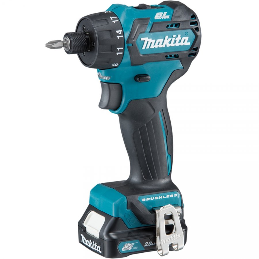

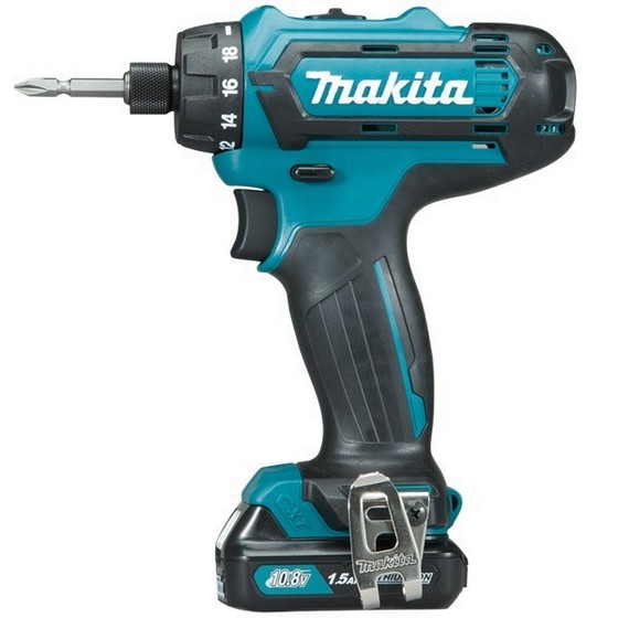

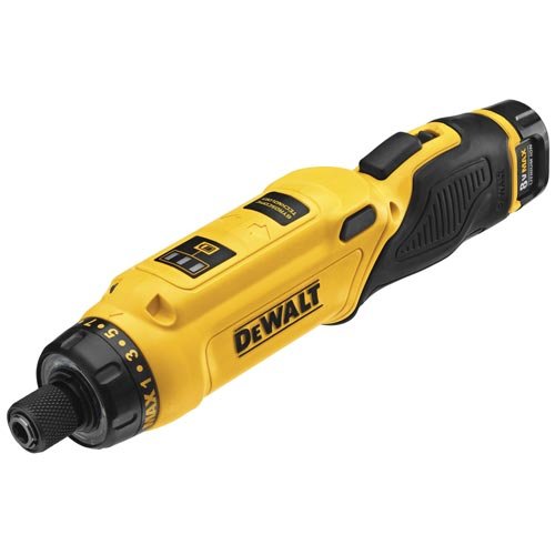

I'd like a cordless screwdriver (not a drill) with a clutch, variable speed, 1/4" drive and preferably a 2nd battery.
I'm not having much luck in finding one that does all that.

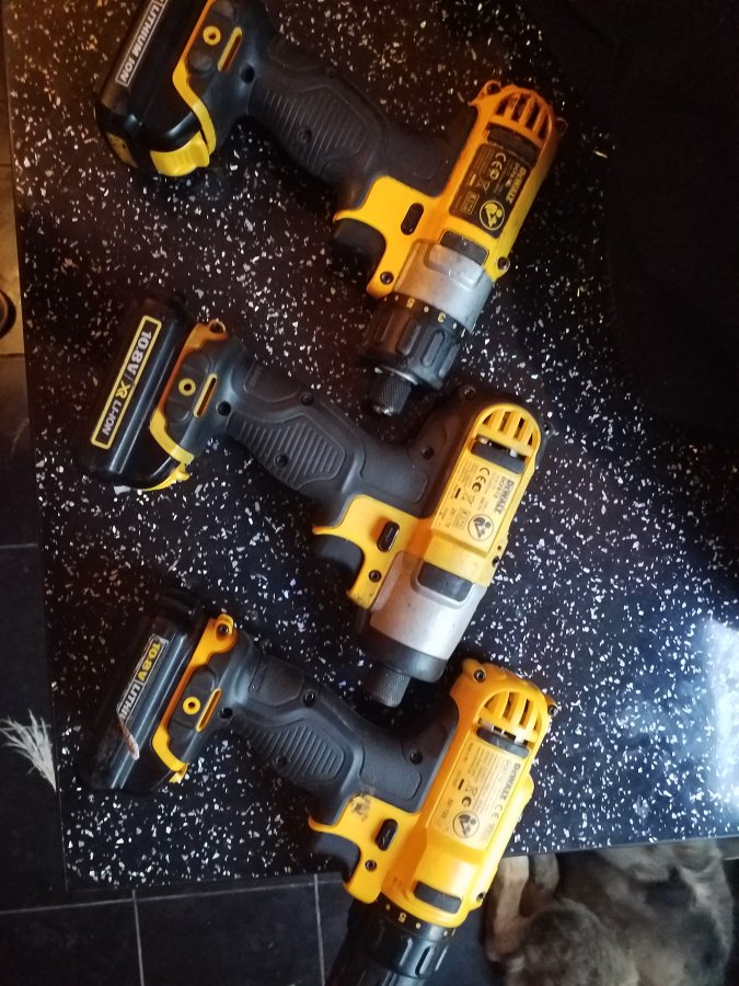

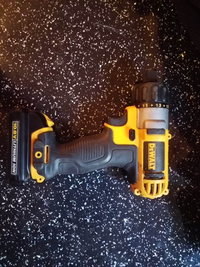

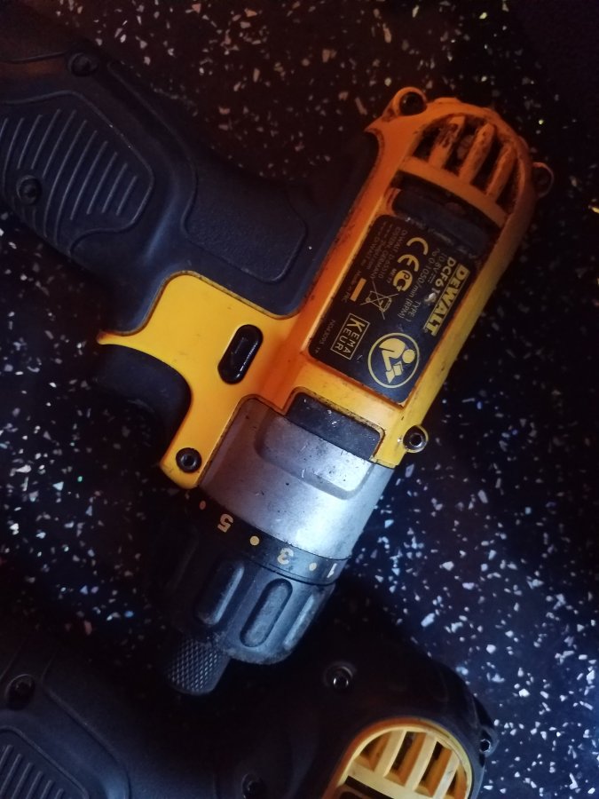

Here's my set of 3, the impact and drill are a combo set from screwfix, £99 + vat, the screwdriver I already had for a couple of years, ok only 1.3ah batteries but for a low draw tool they are perfectly adequate, model number DCF610
Dirt cheap too.....

  • makita-df031dwae-10-8v-cxt-hex-drill-driver-with-2x-2-0ah-li-ion-batteries-pid43910_1.jpg

cheers, as good as the makita etc are these are more like drills than a cordless screwdriver.
The weight alone puts me off holding one of those for hours while I do up screws, the dewalt is more the shape of what I want however as I have to buy my own tools the price of them puts me off (as good as it may be).
I mainly want one for terminal block screws, I can do several hundred up in a day and if using a manual screwdriver by lunch cramp sets into my hand and I can no longer hold anything.
I'm pushing for my employer to buy it (as they should) but that's like piddling into the wind :(
I bought a similar one to the dewalt pictured, it was a 3.6v and to be honest the worst dewalt tool I'd ever bought, absolutely zero torque and would struggle to drive an inch screw into softwood, anything seized or tight then it just would not turn, put it back in it's box and left it in the garage, 4 years later still brand new I gave it away when I had a garage clear out, might be alright for electrical work as is very light and the torque might be enough, you can also twist these in the centre to form a pistol type grip, mine had a push button but did the same thing
