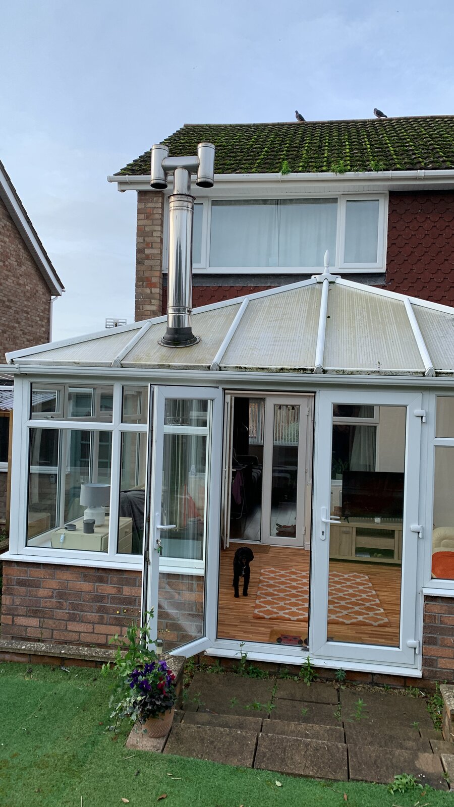

Hi all. Abit of a random issue I’m looking for advice here, I’ve been sweeping my chimney with a brush and rod set bought from tool station.
Unfortunately the brush has unscrewed and detached from the rods, stuck at the top of the chimney about 4 metres from the bottom.
Any advice on how to retrieve this?!
Thanks, Paul

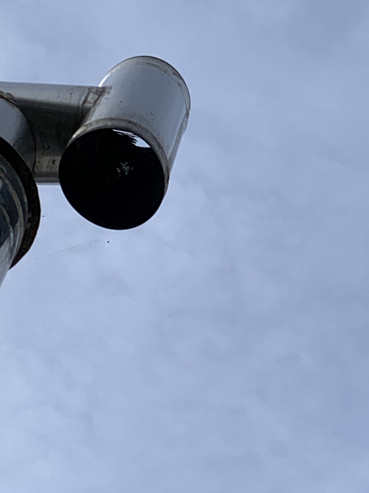

No luck with the hook method, any other idea? The brush is stuck at the top of here, second picture you can see it sticking out slightly
Thinking of lighting a fire to burn through it, abit of plastic and brush won’t cause harm will it?

Great thanks. Without getting up there, are they normally fitted with just screws?
I thought to fit it you would just push it in and it clips in, removal is a reversal of the procedure. Dare say it will be sooted up/a bit gummed up over time so may not want to come off easily.
Theyre only £15, buy another set and fashion a hook type grappling device from one of the attachments that can slide past then pull down on tne stuck brush. Or push up and out of the top as a last resort.
