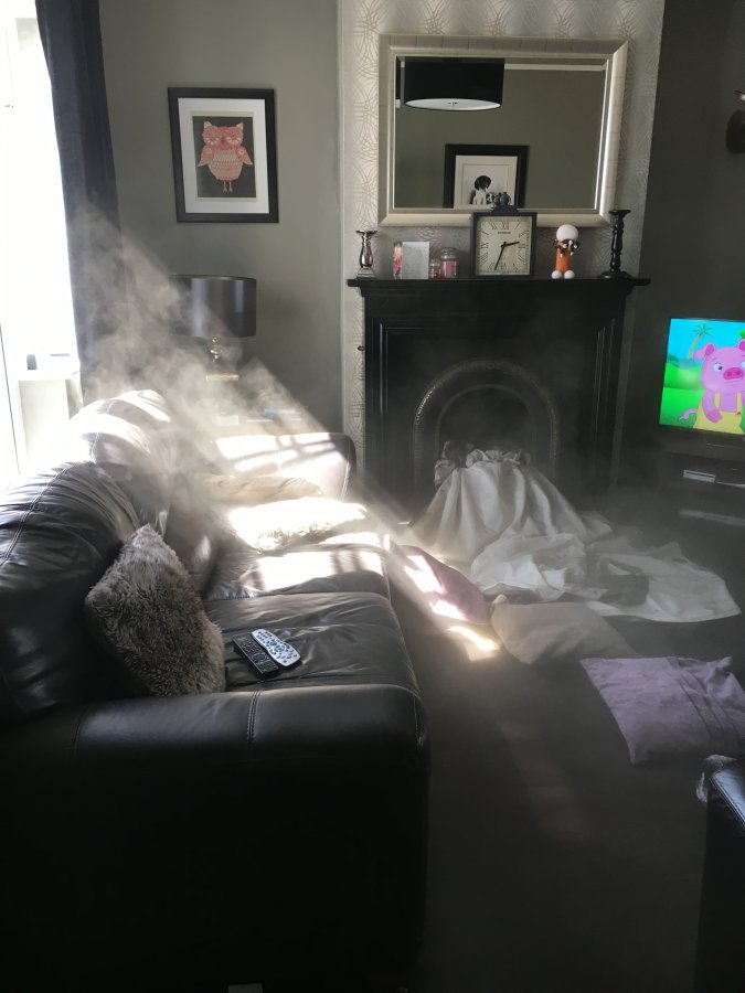

Chimney collapsed
Sorry
Sorry guys I only got shots of downstairs .... Dust dust and more dust all soft furnishing ****ed
Wife is up for divorce

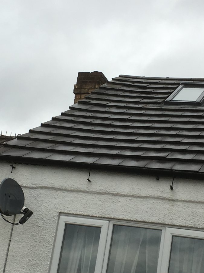

Look at the state of this ..... Somebody please tell me this ain't right cos it sure don't look right

No none of it is right but you need to move on, the original cowboys have ridden into the sunset. So get on the blower to the insurance company or get the hoover out, find another contractor to get on with the job or DIY it.

Yeah that is really bad. The tiles look like Ken Dodds teeth. I guess they fitted the rooflight as well, those tiny slithers of cut tile down the side are a joke.
But look on the bright side, even they were too embarrassed to take any money so you can pay someone else to rip it all off and start again.

Edge Tiles are a joke I know but I'm not sure about getting on to the insurance company though, that will just drag it out and probably cause me a load of grief as they will persue these dicks.

What's wrong with the veluxs ?
They've taken the chimney down and battened across the hole, but they haven't managed to judge the height of the new battens to the original ones. The tiles are level over the old chimney, but have been badly matched in to where they join the original roof tiles. An adequate job at best, and lackadasical at worst.
