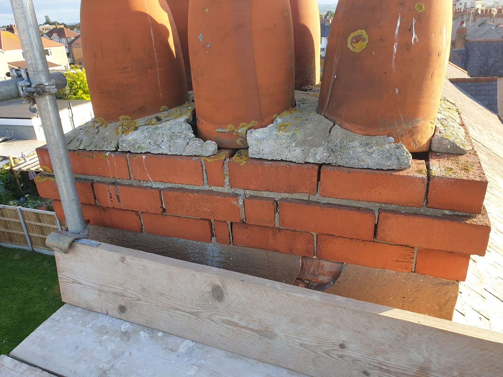

I knew the 1 pot was leaning, but now have scaffold up and have been able to take a better look. I need to redo the flauncing and reset the pots, I did the other chimneys flaunching in 2/1/1 of sharp sand, builders sand and cement.
The top 3 exposed courses are going to likely need rebuilding on this, it looks like an engineering brick. Will a 4/1 mixed of sand/cement be ok or should I use something like this https://www.diy.com/departments/blue-circle-quality-assured-ready-mixed-mortar-20kg-bag/35726_BQ.prd thats got lime in it.
I was hoping to do this tomorrow and no where near me stocks lime.
