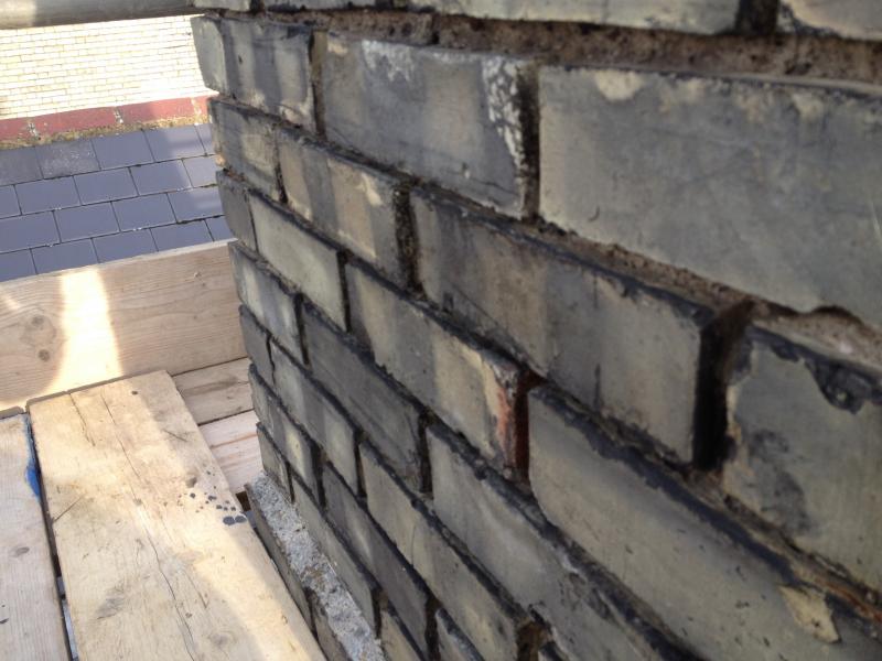

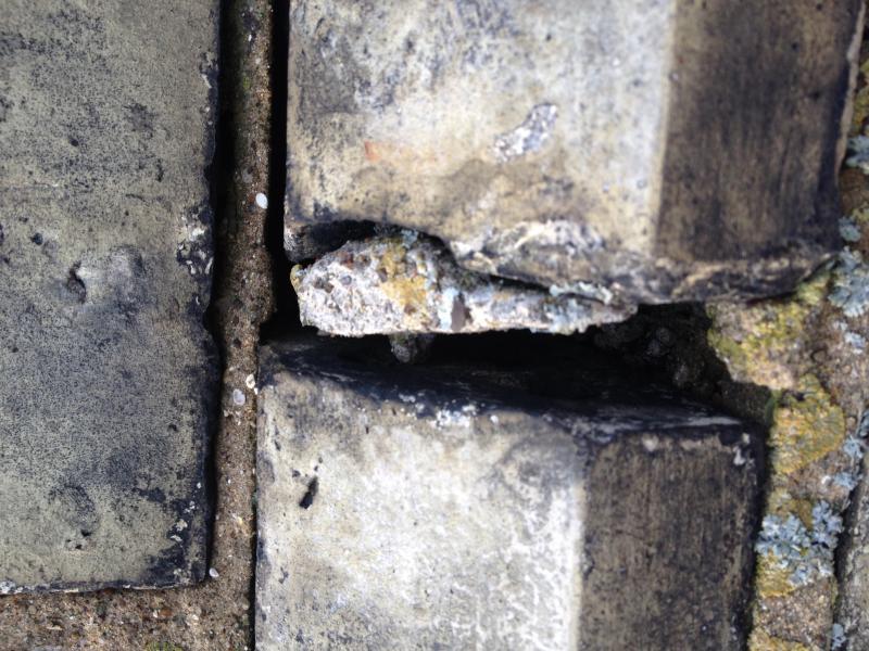

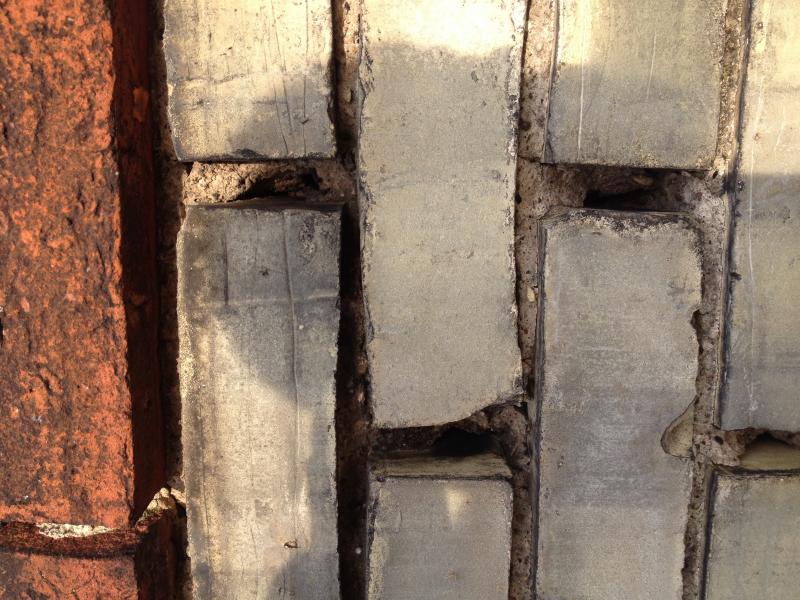

I now have the scaffolding up and plan to do this job at the weekend. I went up today for the first time and could see the real state of the pointing and flaunching. It's terrible and I don't think I need to bother too much about grinding the mortar back an inch as in most places it's weathered back there far already. The shear amount of weathering shocked me and my initial plan was to use the lime NHS 3.5 and sand mix for the stack pointing only only introduce cement for the flaunching. But given how much the stack has weathered I was wondering weather I should use a cement:lime:sand mix fir the stack too. My only worry is that the mortar mix would be too strong for the brick which would encourage the brick to deteriorate.

The main reason stacks deteriorate a lot is because they have been left redundant, if you are planning to use your chimney then I would think that is more beneficial than what mix you use. The last chimney I pointed I used hansons hydrated lime which is a mix of sand, cement and lime. You do not need to always use a grinder, you can use plugging chisel and a bolster to get the old mortar out if its soft enough.

The idea with lime mortar in the joints is not so much that it breathes from within the stack, but any moisture in the outside of the brick will go into the joints and evaporate. With a hard cement mortar the moisture will stay in the edge of the brick and break up the brick with freeze/thaw. Lime mortar is sacrificed in time and can be repointed.
It depends on the bricks whether or not cement will damage them. Soft ones are more at risk. It can take a long time for the damage to show, so a lot of builders think the pointing they did with cement was OK.
Thanks Stuart, this was my initial concern. I guess if I use a cement lime sand mix it could be too hard and the brick could suffer or if I use a lime sand mix then the mortar might not last as long.

The bricks are known as a Cambridge white in this area and they have about 9 holes in each brick. A big like a type of air brick I guess.
