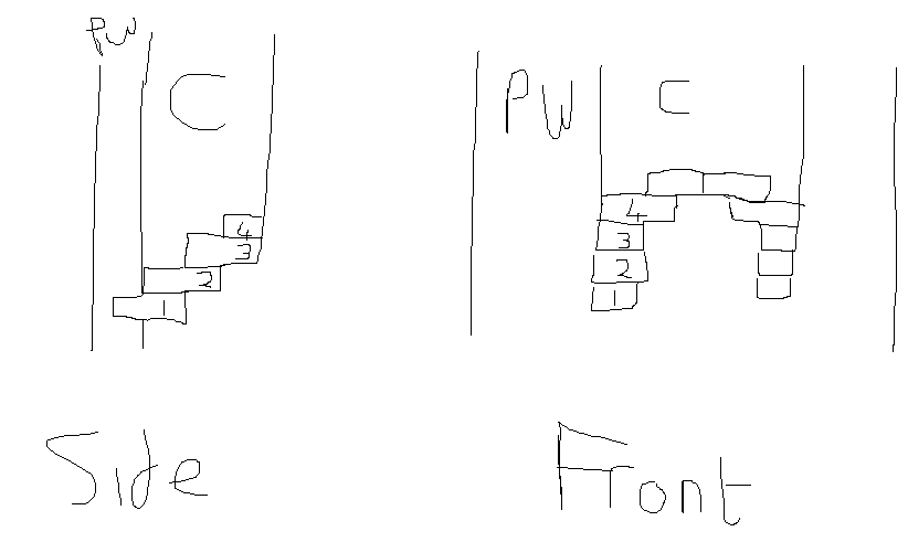

Sure, I can go for that, in the sense that a lintel only truly supports the triangle of bricks over an opening, but surely then if the entire remaining stack were intrinsically stable simply by removing the lowest loose bricks (the ones that rest on the brackets and have no support from any other brick beneath it) you'd have a nice triangle of bricks stepping out, away from the party wall and upwards as they turn the corners and head towards a meeting point -> to this end can you argue that gallows brackets are unnecessary as the same effect can be achieved just by removing bricks? Why doesn't everyone just do that?
I've a suspicion that combined with the deleterious effects of combustion salts on the mortar holding the bricks over the years, that gallows brackets are supporting/intended to prevent the collapse of more than just a few of the lowermost bricks, no?
Essentially you're right, but you'd need to corbel the whole chimney breast to stop the bricks in the middle from dropping. Your method only deals with the sides. And as to the chimney breast forming a buttress on a weak internal wall, you've made a good point there if it was single wall. It's a shame more people don't think outside the box like you seem to.
When you say bricks in the middle, do you mean the bricks making up the chimney that are furthest from the part wall? Would they not be supported by the sides (albeit one or 2 might fall out)?
I made this sketch to highlight what I mean:

That's what the plate sitting on the gallows brackets designed to stop. Your corbeling trick works for the side, but not really for the front, unless it's a pretty narrow chimney of course. Once bricks start falling out, anything can happen - and often does.
