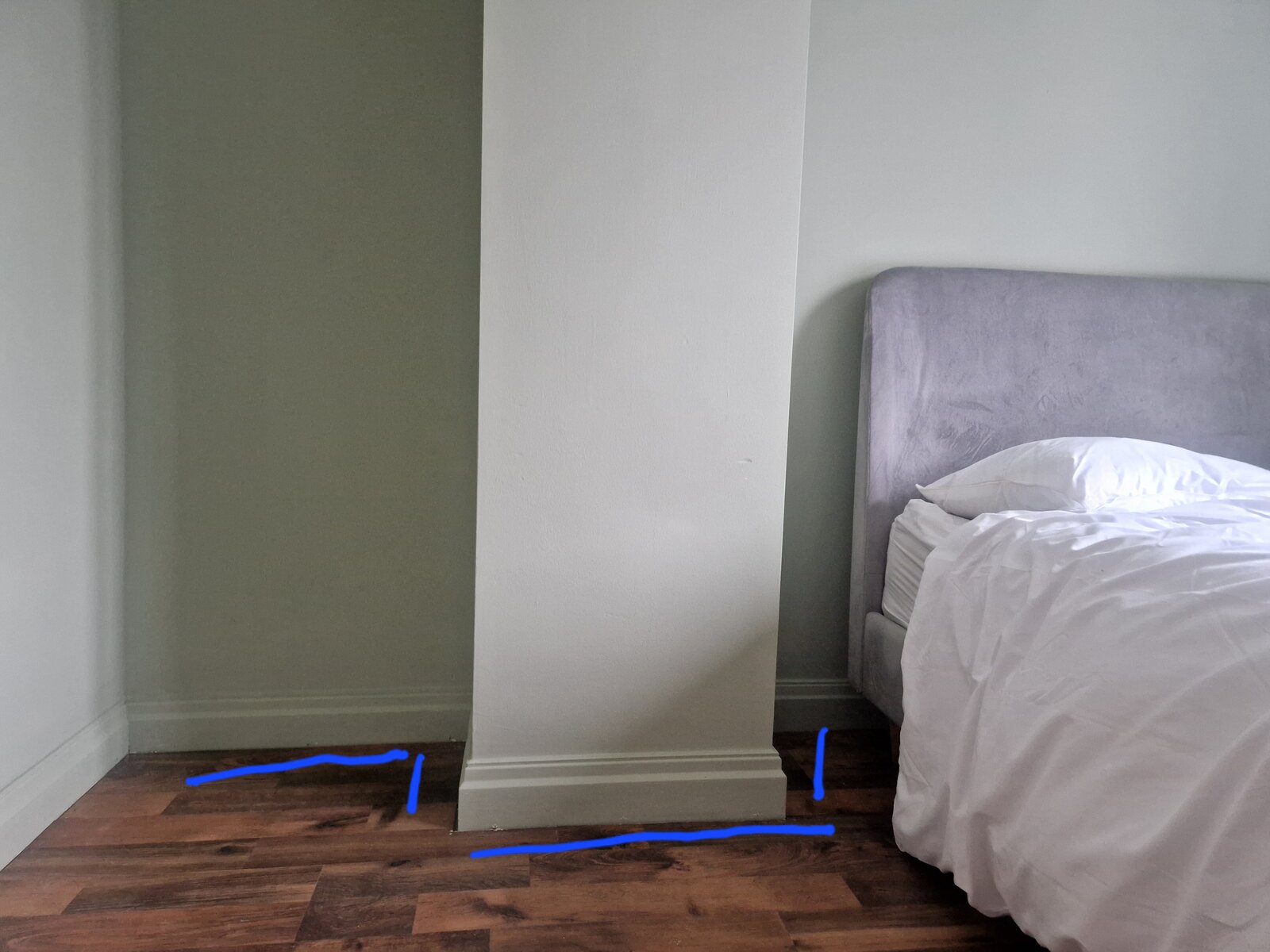

Having a bit of a disaster at the moment... we took off the laminate beading in our spare bedroom (upstairs) to paint the walls as eventually we are going to get carpets.
Next day and over the last month the smell of cigarettes has been getting worse and worse and the room smells so bad of cigarettes when you walk in!
We know that the neighbours next door smoke heavily. I sniffed around the whole room and the smell is coming from the flooring where the beading has been taken off. The issue is no where else in the house. I have added a picture where the base of the skirting board and floorboards smell and possibly where the smoke is coming from.
First of all, is this normal?? I didn't think that smoke could travel between walls! I have lived in a lot of houses and we actually bought this one and now have realised it smells of smoke and no idea what to do.
Any suggestions?
Any suggestions?

Seriously though, party walls suck. Or rather, living near other people suck. Lived in a few that either transmit sound or smells from gaps in the wall, presumably where the joists sit.
Short of ripping up the floor and trying to plug them (messy, difficult access, no guarantee of success etc), why not put the beading back on as you know it works? Maybe squirt some silicone sealant in the gap, or Cork edging strips first to further block it up?
Then air the room out for a while and count yourself lucky that you can block the smells and its only one room

Unfortunately, this can happen.
I live in a Victorian terrace and have the same issue (with a smoke smell a lot more pungent than cigarettes :sick:).
In the 'main' part of the house, the joists run back to front.
In the 'extension', housing the kitchen and bathroom, the joists run side to side - meeting in the party wall with some pretty large gaps in between.
Apart from the smell, we also had rodents coming through the gaps.
I have since taken up the floors and filled every gap with wirewool and expanding foam - so far the problem seems to have subsided, with only the occasional whiff.
For you, the laminate and beading may have been acting as a decent seal. When you move to carpets, you may first need to investigate and seal what's under the floorboards.

Would overlaying the floorboards with 4mm ply and taping the edges (with the tough metal tape or something meaty) be an option? Then underlay and carpet.

To do a proper job, you need to take the floor up and block the gaps in the brickwork, where they have not been plastered over. Some of it will be shoddy bricklaying, and some will probably be where the joist ends are clumsily built in.
Pink, fire grade expanding foam is ideal. Clean out dirt first, and moisten with a garden sprayer to help it stick.
You can also use an extractor fan, turned round to blow fresh air into the room, which will raise the pressure enough for draughts to blow out, not in.
For more money you can get a positive pressure ventilation system.

A little dark, my husband said the same I was like wtf I think we'll lift the laminate and add sealant in those gaps and try to completely seal any gaps between the skirting and floorboards and hope for the best with underlay and carpet.
If you lift the laminate you also have the gaps in the floorboards to deal with. At the moment it's just the edges...
That's why overboarding and taping *may* be an option...
