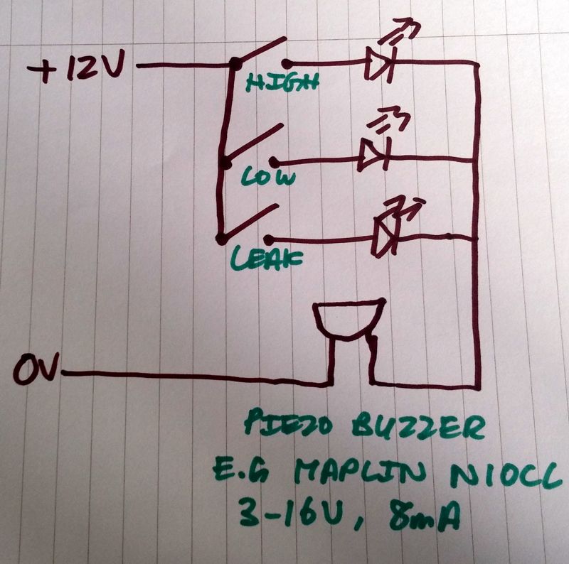

Circuit Help

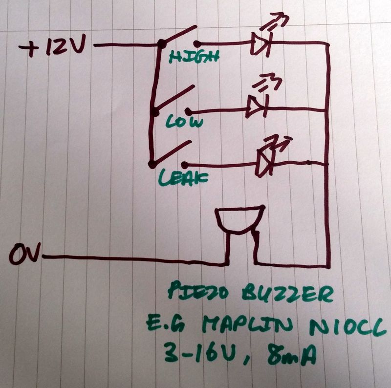

Buzzer in series with LEDs is a bit dubious. I'd put a resistor between +12 and the switches to set the LED current, and then a transistor to turn on the buzzer:
This still suffers from reduced brightness when more than one switch is on; you can largely fix that with more resistors.
