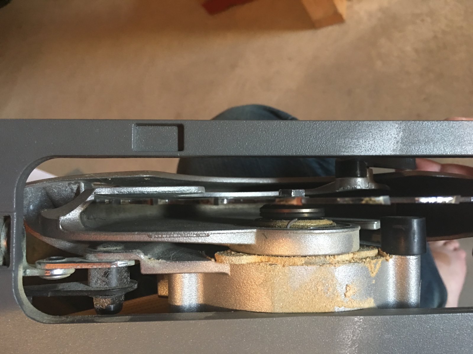

Circular saw damage after kickback?
Looks like it's spaced too far from spindle as if it's been built back up wrong. Spacer/washer wrong side of blade.
Definitely looks assembled wrong.
Some of these machines should never reach diyers hands.
There was some chap who even put a circular saw blade into an angle grinder.
He got a kick back which sliced his jugular.
Looking again at the photos the outer side of the blade is missing a flange washer so definitely installed incorrectly.
Woooow I think you guys are totally right. I've been using this thing mis-assembled for years. I checked and yeah the old blade was a little thinner so i guess it never rubbed. Wow that's embarrassing, thanks guys :)
In image 2560, it looks like you have got...
Flange -> washer -> blade -> bolt
When it should be...
Flange -> blade -> washer -> bolt
Well done rsgaz. Sometimes the simplest answers are the right one. He's refitted the new blade the wrong way round.
