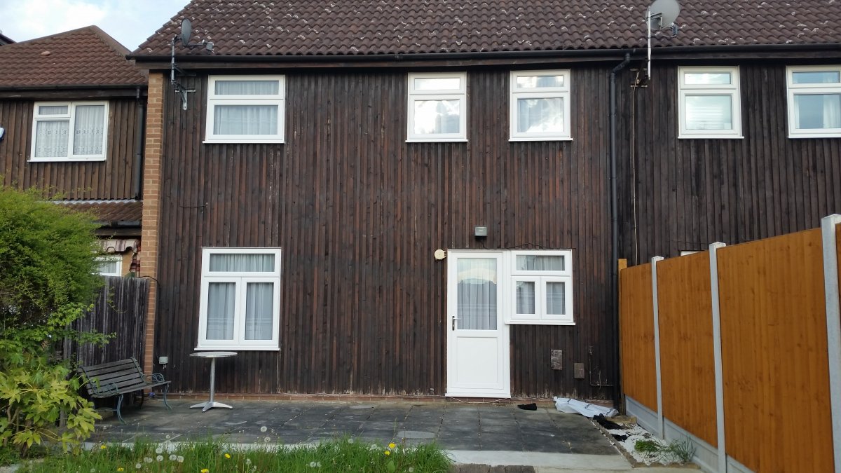

I need to replaced the 35 year old (rotten in places) timber cladding on my timber frame mid terraced property, which covers half the front of the house and the entire rear fascade but am at a loss as to which option would be best.

Here is an old picture of the front of my property if it helps
I would do as you first said. You are also required by regs to improve the insulation if you are replacing that much cladding.

From that picture your cladding does not look too bad maybe sell it on or reuse it to make a shed etc.

Here is the rear of my house, as you can see it would be quite a big job. It is rotten all across the bottom.

I would stay well clear of the guy who wants to overclad you old timber!
stripping it back to its structural timber and insulating is the way forward.
