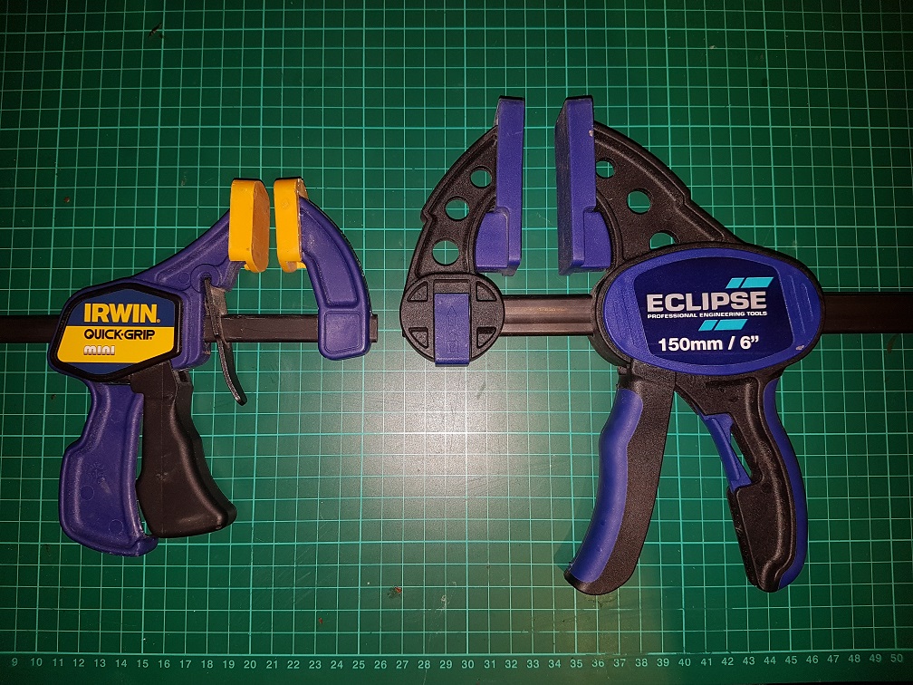

The Eclipse G clamps I have are the best I've ever used. They are monsters! So strong.
Depends on the force you need though, you're probably better off starting with the F-clamps and quick clamps for general woodwork. I have some Irwin quick clamps, which are very good, and again, 2 Eclipse ones which the jaws are HUGE and much stronger!!
These ones...
and these...
Gaz :)
I just took a picture of them to give you an idea of the difference...
I realise the Irwin ones say "MINI", buy they are comparable, because they are in the same price bracket, the Eclipse ones being a bit more expensive.

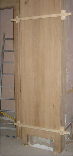

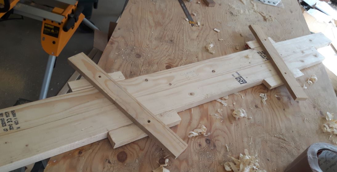

With on-site work it's often the weight/volume issue which is most important - especially if you kit has to be lugged up to the top of a 4- or 5-storey high Victorian building without lifts. For site use I do have a dozen or so cramp heads which fit onto softwood "bars". These can be very useful occassionally, but I don't carry them unless they are absolutely necessary because I can often make-up some quick and dirty panel clamps like these:
Those examples are clamping for pennies from semi-scrap materials. I'm not saying that they'll do for everything (they won't - I do have some heavy stuff for workshop use as well), but looking round the 'net it does seem that some people seem to have a bit of a fetish about clamps, especially about Bessy clamps!
