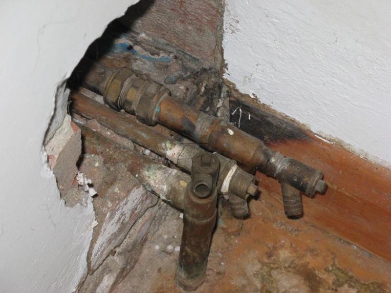

I did remember these three "pipes" which are behind the freezer in the utility room. I have no idea what they are! Anybody?

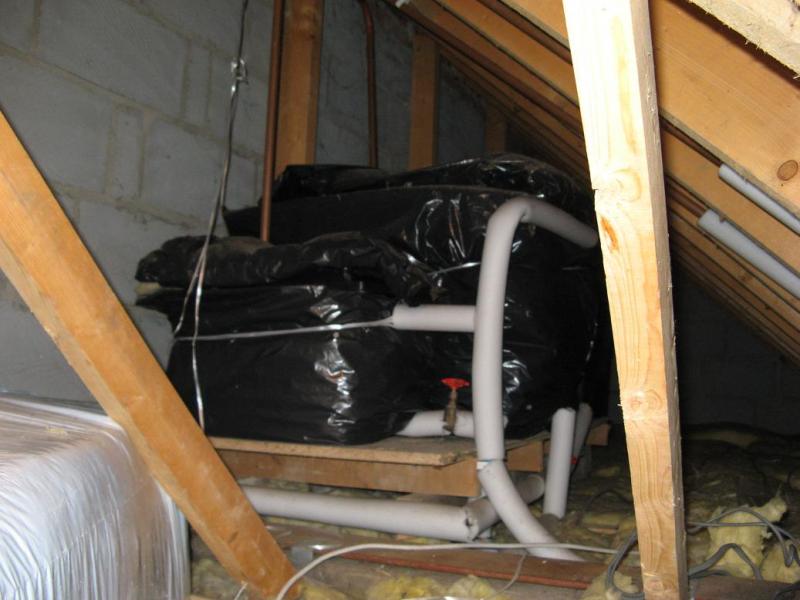

And another thing. There is a valve on the outlet of my F+E tank. If I turn that off and then drain 300-400ml from a radiator (or however much is necessary), could I then simply inject the concentrate into the radiator, close the bleed valve again, re-open the F+E stop valve, smile at how quick and easy it was? Or have I missed something there?

you could, but water will be trying to come out of the bleed valve all the time you have it open, and will probably push the chemical back into the room so it spills onto the floor. To avoid this you will might have to drain as least as much water as if you were filling via the F&E, and you will have to empty the F&E as well.
there should not be an valve on the F&E pipe as it is one of the two pipes by which pressure can escape in the event of an overheating boiler.
Oh yes, didn't think of that. Doh! OK, well back to the normal bottle via the header tank in that case.
Well, there is something there and I presume it is there to close the pipe. Whether it is technically called a valve or not I don't know, but I presume so. Here's a pic:
yes, it appears to be a gate-valve with a round handle (stopcocks have T-handles)
Thanks for explaining. I'm going to be a qualified plumber by the time I'm done at this rate!
So, should this be removed then if it is not supposed to be there?
OK. I wonder what the hell made them put it there in the first place. Mind you, that same question could be asked for a lot of what has been found in the loft. And the rest of the house come to think of it!
