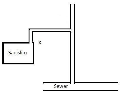

I should mention that the outflow from the macerator head immediately drops down through a 32mm pipe to the floor void on a 10 metre run to the 110mm stack, avoiding the need for an AAV separate to the unit.

That sounds like gravity is sucking the waste out of the tank. I am not sure that is a good idea. Looking at Saniflow data the level sensing is by pressure from depth of waste pressing on a membrane that operates a micro-switch. Gravity sucking would reduce the pressure in the tank and stop the motor. That could explain why it is two or three short bursts and not continous running until the waste has been pumped down to the "empty" level.
I would be looking at fitting an air gap or air admittance valve to prevent gravity syphoning ( sucking ) waste out of the tank.
Quite where do you propose this air gap or AAV be fitted?
As per this
Effectively a soil stack pipe with the vent high enough to not allow sewer gas to enter the building. Or an AAV a foot or two above the end of the pipe from the Saniflow to avoid pumped sewage being blasted into the AAV. Arranging the end of the pipe to be pointing down the stack would ( should ) eliminate the risk of the AAV being contaminated ( and hence not closing )
The vertical pipe to be larger diameter than the pipe from the Sanislim

The way the Sanislim is operating is correct - short bursts in a gravity based system is OK. The AAV function is managed by the breather cap so no other vents required.
The gurgling could be caused by the weight of water pulling the basin trap - cured by fitting an AAV trap to the basin.

What I said was based on the experience of installing a Mono Mutrator whole house system and the need to prevent gravity sucking waste out of the tank. ( sewer and tank were almost as the same level )
So you're suggesting that the Sanislim should 'fire' it's contents into an open pipe when it operates?!?
Most pumped systems do when they discharge into a stack pipe. I have never seen sewage coming out of the top of a soil stack where a pumped system has been involved. That said where a pumped system discharges into a manhole ( inspection chamber ) whch has a lateral 100 mm pipe to the sewer some care has to be taken with the benching ( bottom of the chamber ) to reduce the amount of splashing that occurs.
