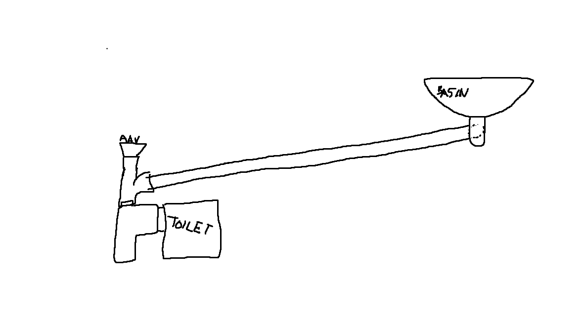

excuse the very crude sketch, but this is what I meant by the last comment in my last post
ignore the lack of bends and accuracy. Basically if the only purpose of this AAV is to protect the basin trap from pulling when the toilet flushed then is it ok to put it near the pan connector as shown? the system just needs a soure or air between toilet and basin? I think this makes sense

AAV's should, technically, be fitted above the spillover level of the highest appliance, (usually the basin), but doesn't always happen. I'd try and give things a test without one to begin with, if there's an issue you can retrofit one afterwards?
A macerator is always a last resort, 110mm pipe is infinitely preferable if the space is available and a suitable fall can be achieved.
@Hugh Jaleak yes i hear you. I know it should technically be above the spill level of the basin but is that assuming you are concerned about the basin water siphoning the basin trap? if you are only really concerned about the toilet siphoning the basin trap (i think in my situation that's the case?) then does it only need to be above the level of the toilet?

I've always believed an AAV needs to be above the basin to keep it 'dry', i.e. if the pipework were to block, it could possibly be forced open with pressure of the water backing up, and make a mess. If you're happy to take the risk, it can be fitted where you like.
