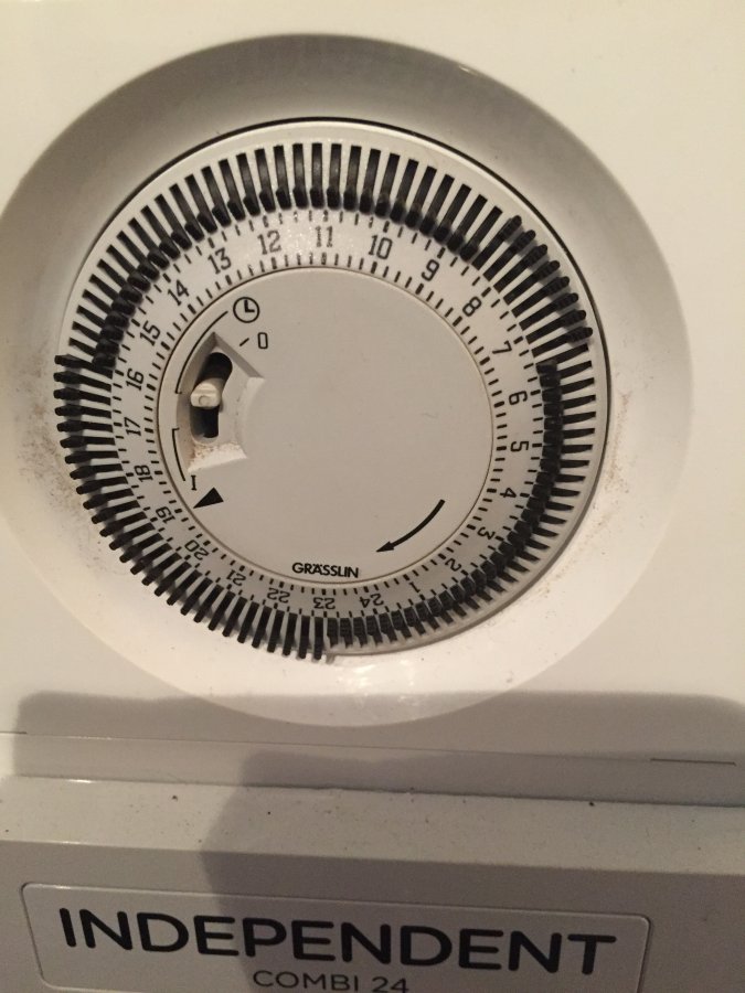

Hi do I have to alter anything on the clock on my ideal independent c24 combo? Or just leave it as it is as clocks go forward tonight
It's the one where you set the pins in or out
This one
I have it set to come on at 6.30 go off at 9 so change to 7.30 ?
No - you don't change the settings. Just rotate the dial so the pointer at the lower left points to the correct time.
And in the autumn you will have to advance it 23 hours. You'll break it if you try to wind it backwards.

Of course not. Just wanted to know so I could tell my helper what to do.
