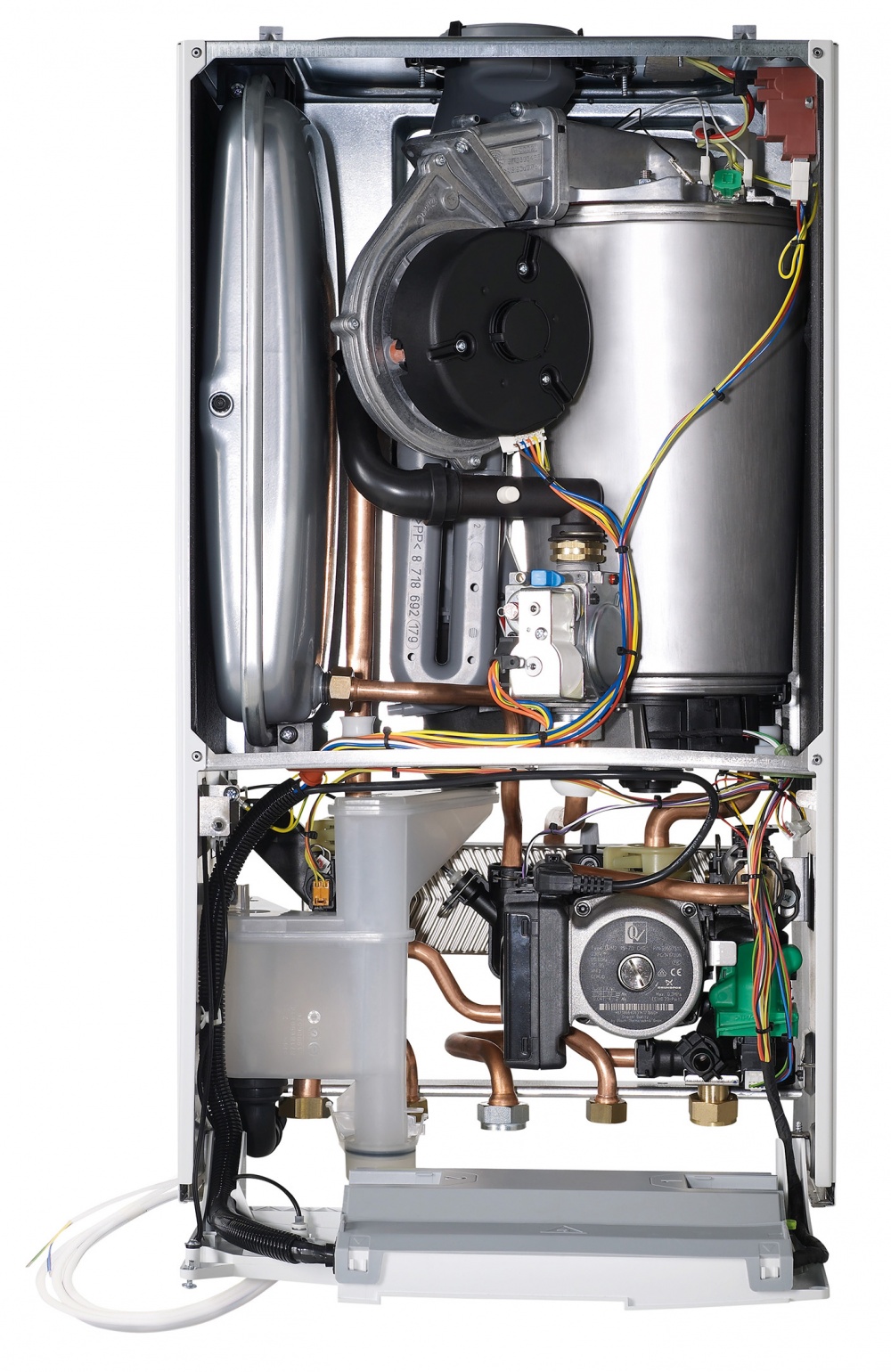

When you lifted the case if, there would have been a rubber seal which seals the case to the room, which prevents the products of combustion entering the room, hence why it needs to be a gas safe registered engineer.
Sorry, but i watched many times technicians take this cover off and it's just a flimsy piece of metal sealing nothing.
There's no gasket, washer, rubber or anything that could prevent a leak.
It's bare metal painted white.
If there's any seal it would be attached to the internal part of the boiler, but I never saw one.
Also, looking at this picture, there's nothing of that sort.
Depending on how new the boiler is, the inside of the cover that's been taken off will have a nice big black rubber/foam seal on the inside. That creates the room seal against the boiler case.
Once the cover has been removed and then refitted then the boiler should really be checked using equipment that most normal users wouldn't own. Any room sealed case that is removed by a user is taking a risk that it isn't re-fitted and then sealed properly.
No matter how small that risk is it is still ill advised.
I stand corrected, however it must be as Rob said, a seal on the back of the cover case. There’s x2 side panels that appear to be foam insulated as well.

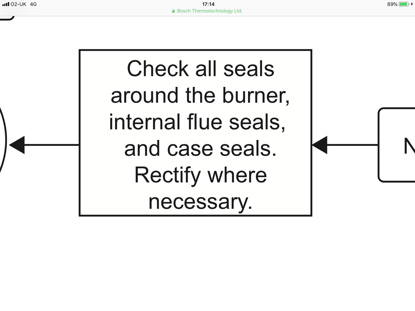

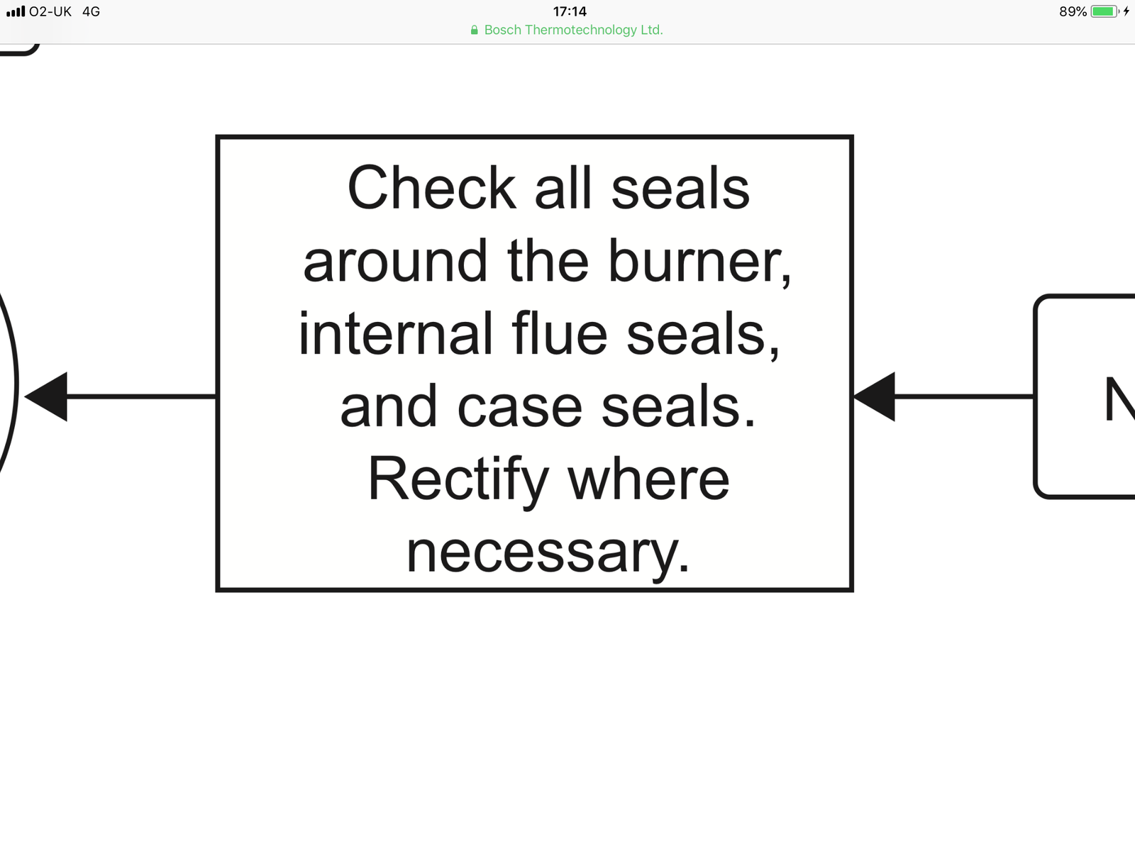

Here’s a piece of information from a current 30cdi model:
Guess we’ll have to agree to disagree on this one.
Edit: one thing when on a Worcester training course, they said flue integrity check must be carried out.

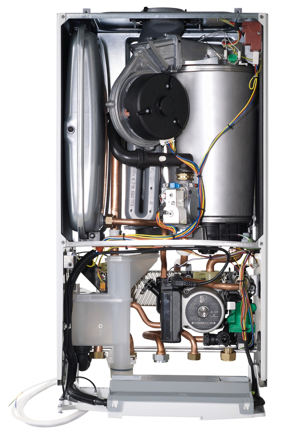

Nope he's not at all .... most, if not all of the newer greenstar CDI's have a front case like that. The large black rubber sheet seal fits against the faces of the upper combustion square as seen in your picture(the square that has the EV/main HEX, etc in it). All the pipes/cables entering from below into that combustion space are sealed in by grommets and glands. That way that upper square space stays room sealed.
