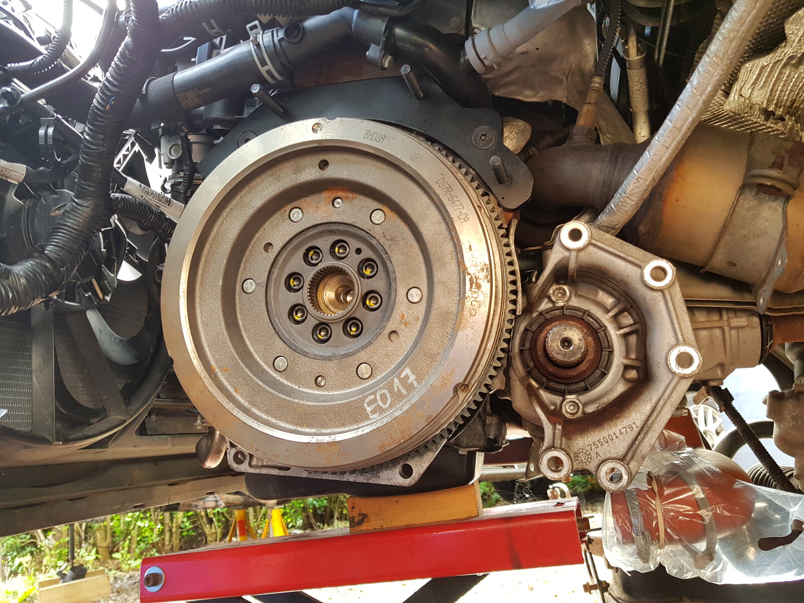

My Kuga DMF was steel, and bloomin heavy!
The one I have sitting in my office at work for our Golf is steel too. Not a grain of titanium to be had. You need a heavy mass to smooth out the engine strokes, especially on tickover so I don't think titanium would be suitable. I had a lightened flywheel on the RS engine that I built. Couldn't get it to tick over below a thousand or so as it had no ooomph to continue the cycle.

A bit of searching suggests they talk about them in racing circles, most suggest they only might be useful on the track, but for normal road use no. Aluminium might be more sensible, but the only useful plus point, is reducing a vehicles weight, making it rev up faster and loose revs quicker, but they whole engine runs rougher.

Mine is at the garage as we speak 155k on the clock, so can’t complain.
I’m banking on a complete clutch & dmf... although did notice the slave unit had also leaked its fluid... So we’ll see. (y)
Your mechanic is doing the right thing, most would do the same.
I’ve never been convinced by solid flywheel conversions myself so I would just stick to oem and it should give you many more years trouble free service with quality components.
You can, but there are downsides. The transmission becomes much more rough, more vibration and there have been cases of broken crankshafts as a result. They cushion the crankshaft's rotation as well as the transmission from the power pulses. A solid one is 100% reliable, after all - all they are is a lump of solid metal.
The DMF has a sort of rubber cushioning built into them.
We do a lot of work with taxis. When taxi drivers started suffering DMF failures and asking for solid flywheels, we ask the car manufacturer (Peugeot in this case) and they told us we could kiss the rest of the vehicle's warranty goodbye if we so much as thought of it! They said the plastic inlet manifolds would crack, the crank damper rubber would shear and probably (eventually) the crank would snap! It seems a DMF does a lot more than just provide a bit more refinement for the vehicle occupants.
On the other hand, my sister had a clutch put in her 2001 Freelander and declined the DMF replacement while it was out, because she's poor. My parents are driving that car to this very day, now heading towards 170,000 miles, and the original DMF is fine.
