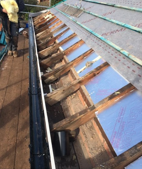

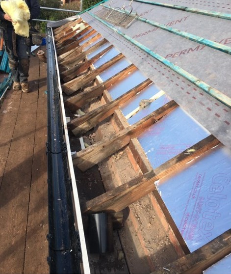

Thank you to everyone that has contributed to this thread. Our house has longstanding issues with cracked plaster, condensation and mould on the curved ceilings in the box bedroom and bathroom. Despite trying to improve heating, ventilation and using desiccant dehumidifiers in the effected rooms this has not been resolved. With the information on the thread I was able to tell my roofers exactly how to insulate between the rafters (photo attached). I'm hopeful this will make a big difference and I will look to redecorate in the New Year.
