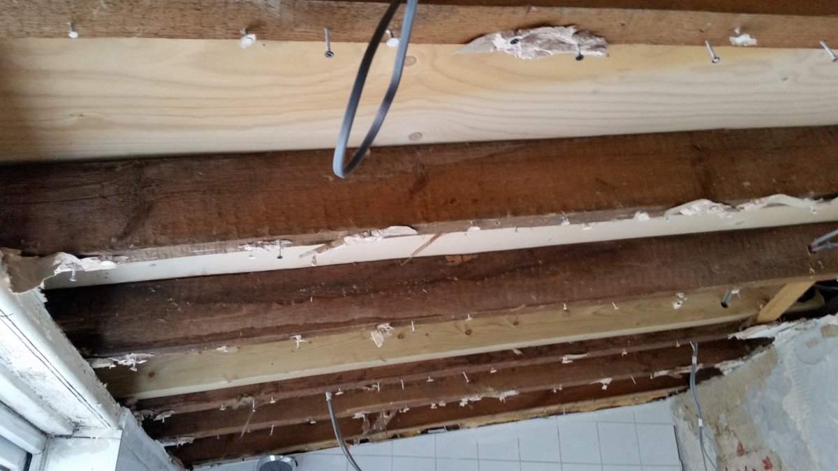

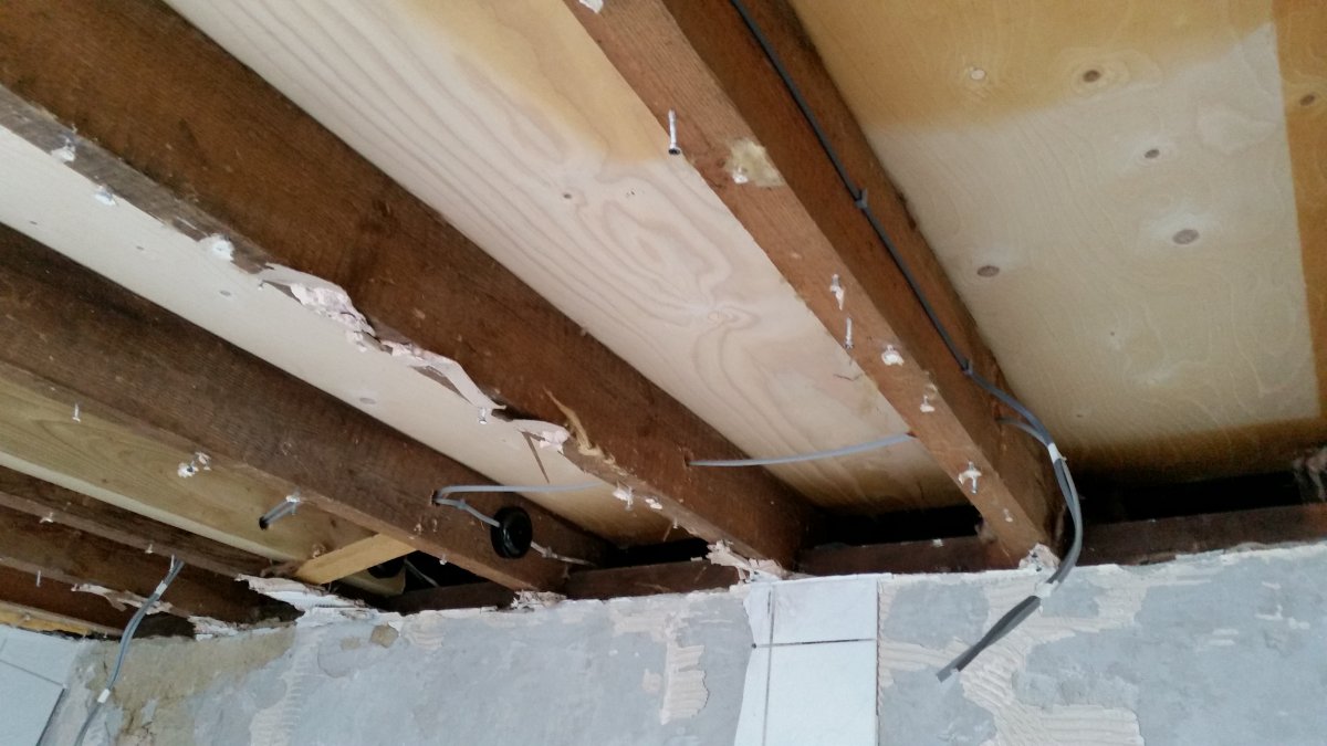

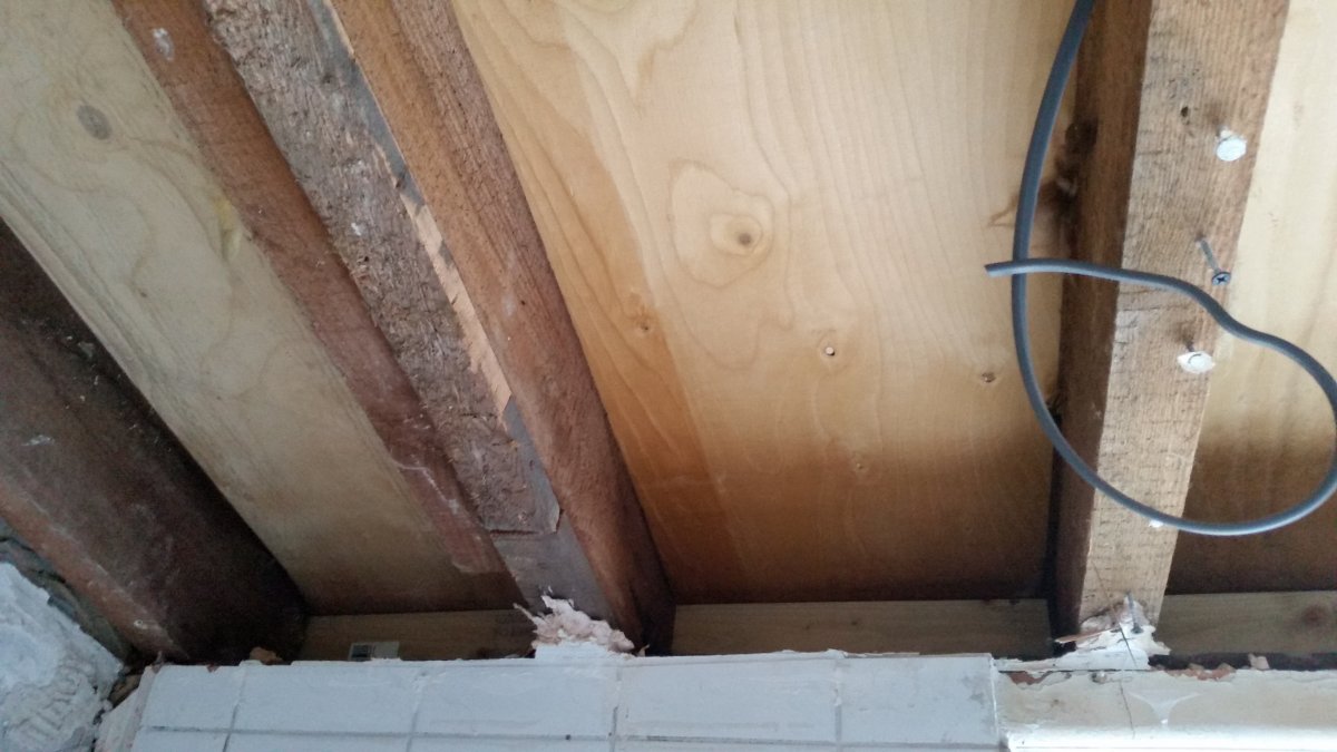

So the Mrs wanted spots in the bathroom so I took down the 2 layers of old ****e ceiling (the underneath layer was mouldy from the old flat roof - we now have a fibreglass roof) and got sparkies in to move the light switch and install 4 spots (read as downlighters) in main bathroom and 1 in the vestibule/entrance cubby.
The sparkies have done their first fix and wires are dangling.... they said celotex is fine for insulation aslong as i leave a gap around the lights - so my intended solution was to cut the board to fit between the rafters and push it flush to the underside of the rafters leaving an air gap behind it and where the lights are to leave a gap so i would cut board leave gap, then new section of celotex - rather than cutting holes out of it which i hear is unadvisable. I also intend to use the plasterboard with the vapour barrier to stop damp/moisture permeating into the cavity.
However i am concerned that there may be "cold spots" around the light fittings where there is an absence of celotex potentially causing condensation and a hazard.

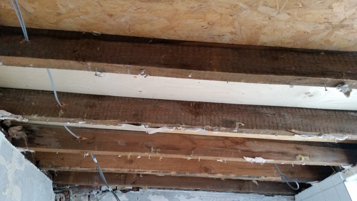

In the second picture there is a non maintenance free junction box in an area where it is clear maintenance won't be possible. Your sparks should have picked this up. It needs changing to a maintenance free type.
The sparks didnt pick them up - they have literally just installed them - ill tell them these are not the correct typ do to lack of access (they could have set these back in the cavity which actually has an acccess hole....

There is no conundrum.
You may not have lights recessed into that ceiling and that's all there is to it.

Because of the requirements of Part L, and (as it's a bathroom) Part C of the Building Regulations.
Basically you may not have holes in the insulation and you may not have holes in the vapour control layer which will allow air through to where the moisture in it will condense. You said "the underneath layer was mouldy from the old flat roof" - there are no signs in the photos that the old roof was letting the rain in, so £ to a p the mould was because warm moist air was reaching a cold surface and condensing on it.
Local building control (southampton) have just said the new fire rated LED downlighters are fine in this type of pitched roof extension and to leave a gap behind the insulation and the roof for air flow/ventilation.
Fire-rated lights provide nothing in the way of a vapour barrier, and you don't need them anyway.
Also you don't look to have enough space for lights, insulation, and then an air gap.
Given that you've pulled down the ceiling and had the waterproof layer replaced, you would have been much better off replacing the roof in its entirety with one better constructed.

Mould in old roof was because it was a felt roof that was letting water through, the boards you see in the pics are ones the builder put under the new fibreglass roof so these are newish.
Yes totally agree with you ban-all-sheds in hindsight a warm roof would have been a much better solution. Wish i would have come here first before getting real life builders opinions - none of whom suggested it.
Anyway - long story short, im going to put celotex in the void leaving an air gap behind and make allowance for space/clearance around the fire rated led units. Then I'm going to use vapour board (the plasterboard with foil back) to create vapour barrier.
As we're only having 4 downlights i will seal these with sealant around them so I cant really see how the moisture will penetrate from 2 showers a day in a bathroom with an airbrick and 2 windows with trickle vents that never gets very damp in the first instance. Also the cavity vents into a larger space with air bricks.
