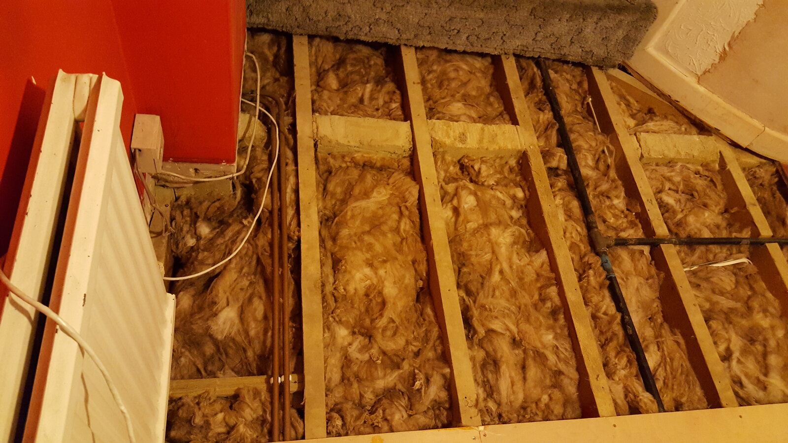

I have now taken up all the carpet and underlay, I can definitely feel a breeze coming from somewhere, I think it may the gap between the skirting and chipboard. Would it be best to silicone / caulk this first? I was then going to lay 6mm ply in living room/hall (to match what's down in the kitchen) then quickstep underlay / click LVT
Are you reluctant to pack mineral wool into the gap, especially round the edges of the room, to block the draught?
There’s not really anywhere to put the mineral wool.
I used an endoscope under the kitchen an looks like there is jablite (but no way of checking if they insulated all the way through without taking up all the chipboard
I’m not sure how I would go about taking up the chipboard as cannot see how they are fastened down (it looks like the chipboard was laid before the internal walls as goes under walls)
that’s why I was just wondering if sealing around the skirting and maybe between the chipboard joins would help

if as I suspect, the "white polystyrene" is Jablite, then you should be aware that it has a higher R value than mineral wool (it is almost twice as effective as an insulator). It would be interesting to know whether or not you have any cold spots in the kitchen floor caused by gaps in insulation or missing insulation, but that would require an infra red (FLIR) camera or a phone attachment (unfortunately the cheapest clip on FLIR I've seen for Android phones is just under £200 - my Androifd phone endoscope in comparison was under £50). As far as insulating beneath the concrete. TBH, having thought about it, I'm unsure that you'd get a huge benefit from insulating the ceiling below the floor because you are insulating a concrete slab which should already be insulated above, so before going ahead with it I think I'd want to see what a thermal imager made of the floor. Incidentally, is the car parking below you enclovsed and if not is it very windy?

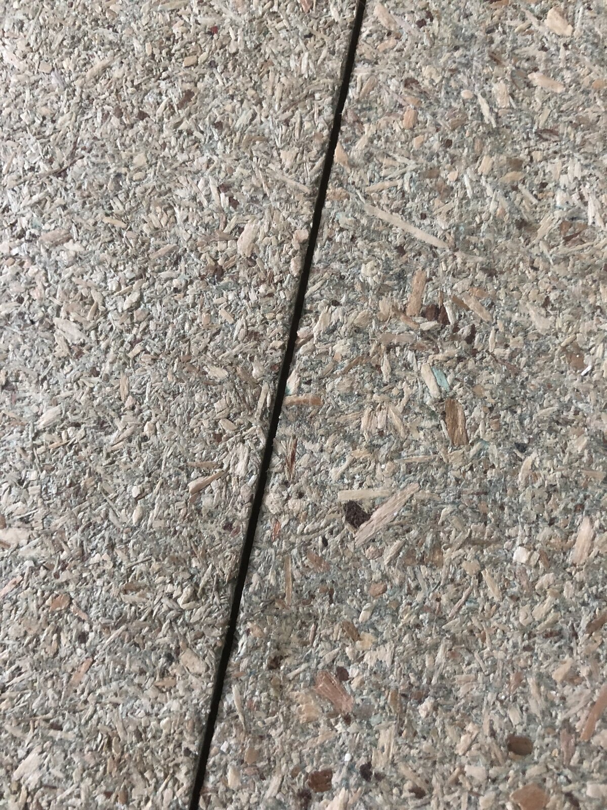

You could fill the chipboard joints with sealant.

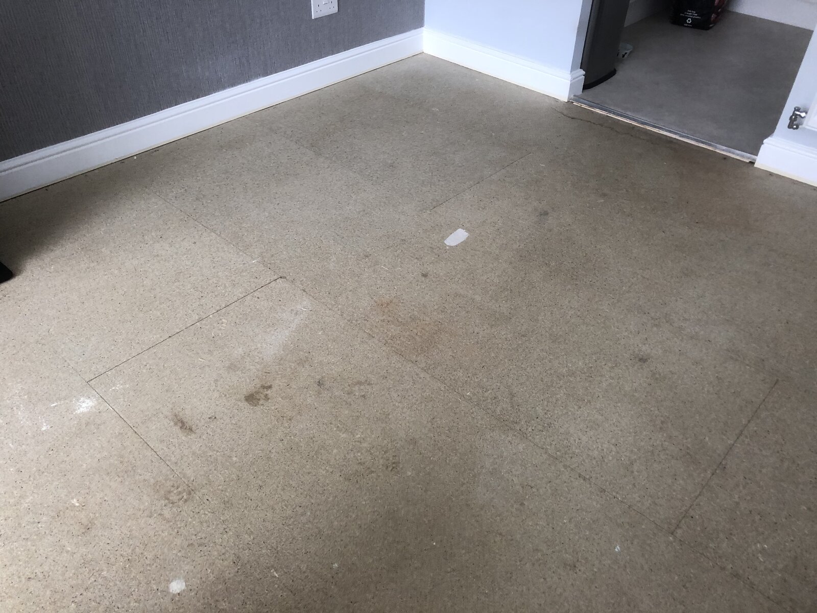

this was what i had in mind. See pic.
my chipboard was ready for the skip anyway, as it had been walked on several times so was cracked.
The draught comes in round the edges of the room, so that's where you need to pack first and most thoroughly. mineral wool does not need to be cut to a precise fit, just stuff it in. Foam and slab will allow draughts if there are any gaps (there will be)
you can use the smoke from a joss stick to find draughts.
under a floor, if you have a gap, you can stuff mineral wool to fill it. It will prevent air movement as well as adding insulation, and will muffle noise a little. Unlike polystryrene or Celotex, it does not burn or give off poisonous gases in a fire.
It can be pressed to tightly fill irregular gaps, with no precision cutting needed.

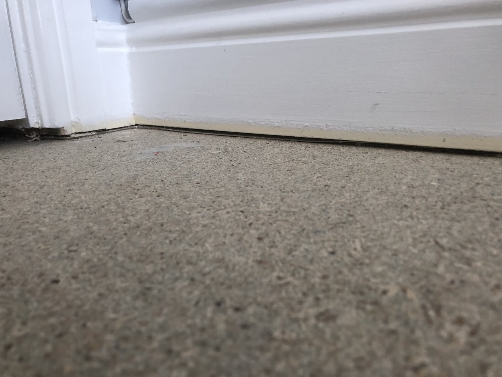

None of the skirting gaps are that large, maybe 1-2mm,

The reason I was thinking caulk may be the better option particularly for the chipboard joins is it can be sanded down so would still be flat in line with the chipboard, if using silicone it is more rubbery and difficult to smooth out. I am having 6mm ply applied over the chipboard so not sure if needed.
Maybe just silicone the 1-2mm gap between the skirting and chipboard first. See if still drafty then rent camera
would this be the best shout for both the chipboard joins and skirting ?

I have used "wooden floor sealant" between to skirting and chipboard to see if helps with drafts.
so, it looks like i have drafts from all over the place
1. between skirting and chipboard - now sealed with wooden floor sealant

4. most of the chipboard is T&G but some of the boards flex in place so not T&G on one side so guessing the gap between the chipboard on the non T&G side is also drafty - might use wooden floor sealant, dont know if need to be fixed in place first as the movement may crack the sealant otherwise
