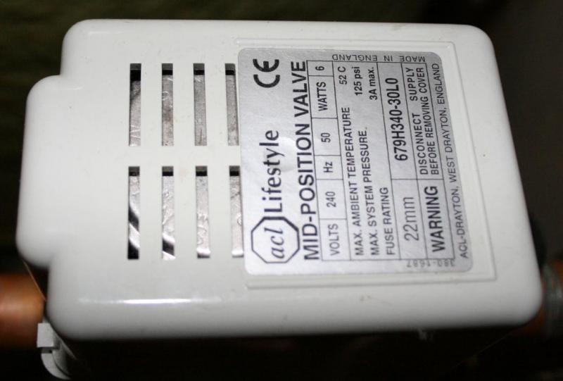

Mid position valve

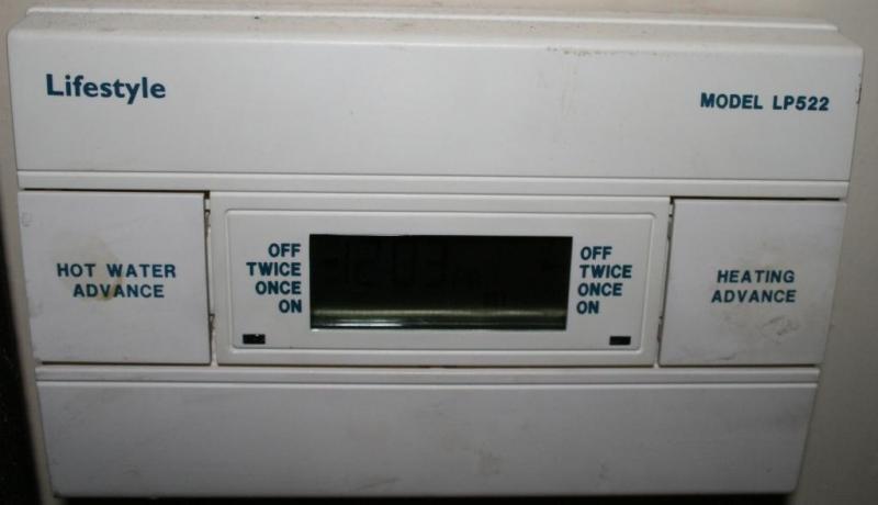

Timer

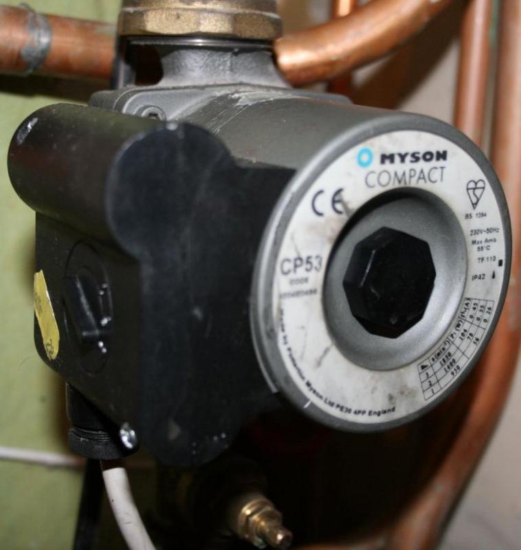

Pump

The Drayton LP522 can control heating and hot water individually, so there is no need to have both on at the same time - it's just a case of wiring up properly!

I was not feeling well over the weekend so couldnt reply or do the wiring. But i did manage to take the control off and check whether it was set to P on the back which it was.

BTW do you have any info on this mid position valve? Apparently i should be able to move the lever to only work CH or HW. But on trying the lever doesnt move at all.

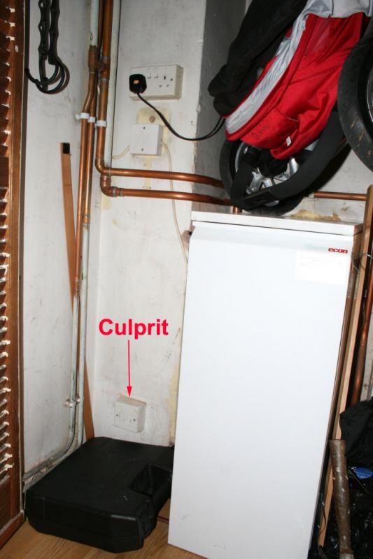

What, the box lying on the floor!! It should be wall mounted. That's probably the one, it should have one or two terminal connection strips inside.

I checked the control and the red lights were off when they were supposed to be on. I tried pushing the boost buttons but to no avail.

The programmer shows the clock and all the programs. You can even set the new ones. It just doesnt turn on. I think i will have to take a half day today and head back home to sort this. How can i isolate power to the CH circuit? Do i have to power off the whole house?

The programmer shows the clock and all the programs. You can even set the new ones. It just doesn't turn on.
Looks as if the programmer has a faulty switch or relay. Remove the programmer and note the colours of the wires connected to terminals 1,2,3 and 4. Replace the programmer. Find the other end of each wire (probably in the white or black box) and temporarily disconnect any other cable connected to the same terminal - note what they are so you can reconnect!. Turn the programmer on and check each terminal for 240V with a meter. The wires connected to programmer ON terminals should read 240v when CH/HW is turned ON; the OFF terminals should read 240v when CH/HW is turned off.
If any of them do not read 240v, the programmer is broken.

Anyway that problem is sorted and i had a laugh. Found the culprit and it is
must have switched off when chucking the hoover in there before leaving for work in the morning.

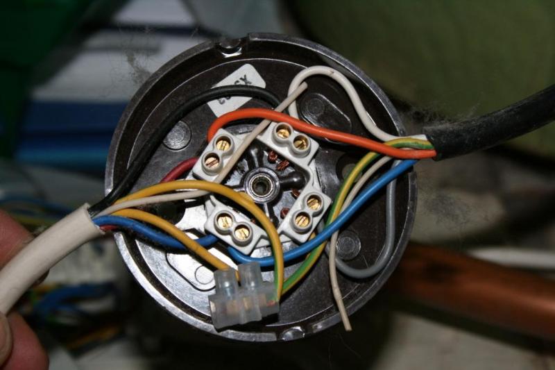

About the wiring it is doing my head in. The board is 12 position and many connections are different. Here is the two pictures. By the way the black one only acts like an extension for the mid pos valve. I am unable to find which feed is from the boiler and which one is from hallway stat.

Spent about 3 hours looking through the wiring. Terribly confusing specially when looking at your diagram as it is set out completely different. It also conflicts with the one in the LP522 manual which you sent the link for. Anyway by looking at the one in the LP522 manual, even though my wiring is not set out exactly on the right slots but the corresponding connections are fine. I can say that for Valve and the Programmer. I opened the valve as well to check if the micro switch makes contact which it does. I have been playing up with the arm of the valve and here are my findings.

The valve moves over two stages. stage 1. power from programmer feeds room stat, then power from room stat feeds the 'white' wire of valve. This drives motor to mid point when micro switch No 1 is triggered.
As HW is not on, there is also a power source from the programmers HW OFF terminal which is fed to the 'grey' wire of valve. So the M/S No 1 has 2 inputs (white and grey) but only 1 output. So at mid point it switches from the white to the grey. stage 2. The grey drives it to the CH only position and it is held there for as long as the motor remains energised.
During stage 2 micro switch No 2 is triggered. This M/S No 2 is also fed from the 'white' wire, but its output is the 'orange' wire of the valve.
So if valve moves to mid point, then room stat is ok, which leaves a query regarding the 'grey'. Does the wire from programmer exist?
Now if the HW was on, the 'grey' would not be live anyhow! cause HW/ON/OFF is like two way switch (only one can be live).
Now the cylinder stat is also like a two way switch, power from HW ON feeds the HW stat and fires the boiler, but when temperture is satisfied the power is diverted out of the 3rd terminal of stat and it joins the 'grey'
See diagram.
Either the valve is moving across to CH only and it does not light boiler due to faulty micro switch No 2, or the valve is not moving across to CH only position, due to incorrect wiring or faults in actuator head (eg motor or M/S No 1)

As stated it's a two stage function. The live 'white' switched on by room stat caters for the first leg. The second leg is catered for by the 'grey' which is powered from either the 'cylinder stat' (if HW satisfied) or the wire from HW OFF terminal of programmer (if HW not on).
Its during the second leg micro switch No 2 is triggered to allow power out of valves 'orange' wire to light boiler( in lieu of cylinder stat).
Microswitch No 1 is fed from 'white' and 'grey' wires and is triggered at mid point to change from one supply to the other.
If for example the 'grey' has reduced voltage or does not exist then valve will never move beyond mid point, so it's important to verify the wiring on this part is correct.
If you select CH only and the boiler lights, it suggests its functioning ok and you can feel at the pipes leaving the 3 port valve.(HW coldish CH hot).
Now if boiler does not light its because either micro switch faulty or micro switch not triggered by valve not having moved to correct position.
Found the culprit ...must have switched off when chucking the hoover in there before leaving for work in the morning.

Not surprised - it looks a mess.
Have you worked out that No 1 is on the right as you look at the picture? I can't work out what the odd wire into T11 is doing - there's nothing connected to it.
That's what I deduced from the pics!
That needs to be done. I also can't see the mains input cable going to terminals 1-3, unless mains goes first to the boiler, via the switch you found, and a cable comes from boiler to T1-T3.
