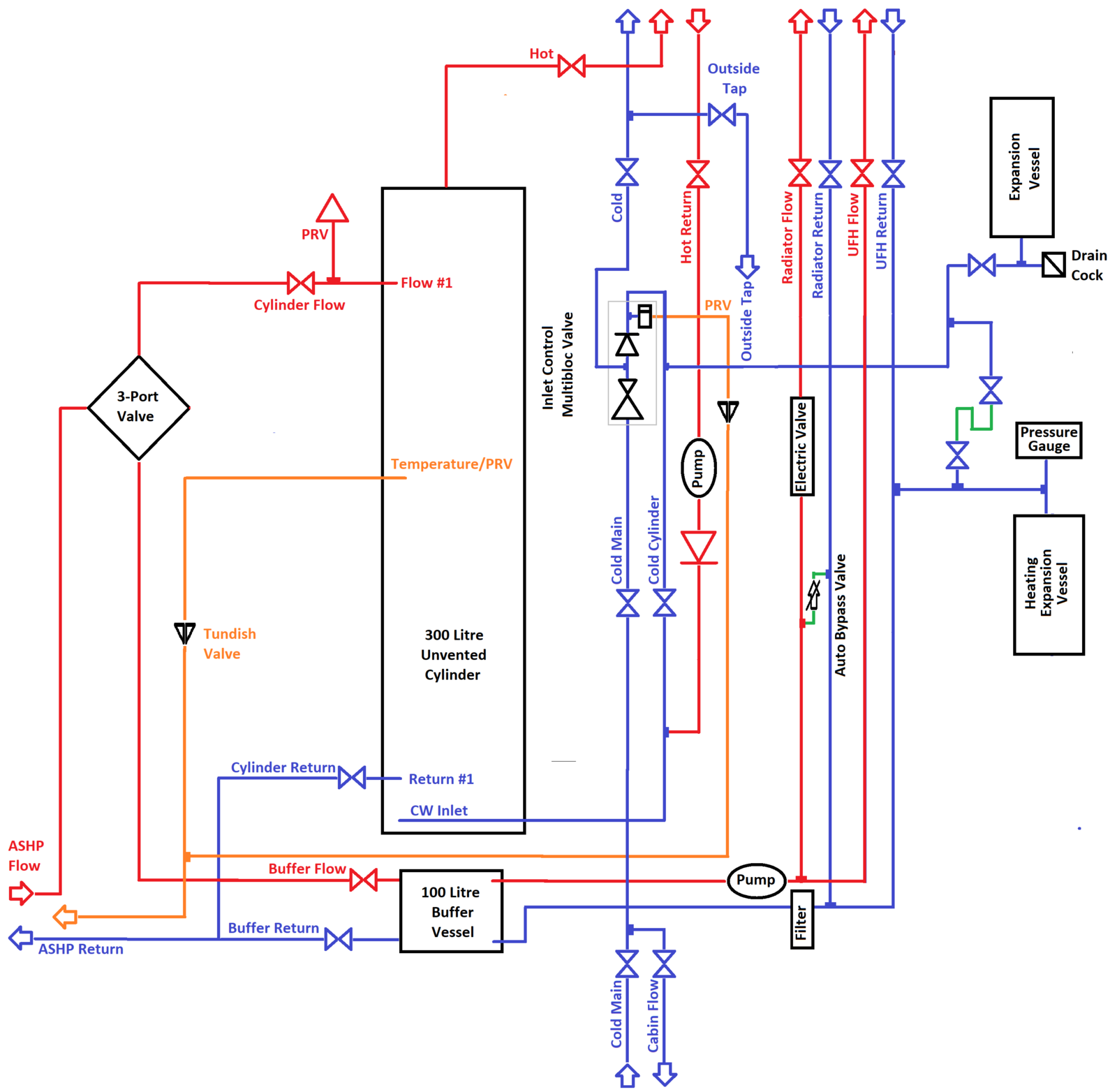

Just to revisit the diagram again - the more I look at it the more I think that it's wrong:
The cold main is entering the group valve and the first thing is to regulate the pressure to match the cylinder.
The first takeoff from the valve is optional and can be used as a balanced output for the cold tap (to match the pressure of the hot of course). On my system, this first takeoff is what feeds the cold cylinder so it's bypassing the check valve built into the group valve.
Note that the built-in check valve sits between the optional balanced takeoff for the cold taps, and the takeoff for the expansion, pressure relief and the primary output of the valve, i.e. the output which should feed the cylinder as this feed is both pressure regulated and protected from backflow (via the check valve).
The pressure relief circuit is fine and routes to a tundish and then to the waste.
The primary output of the group valve feeds the cold tap in my system but it also links back to the cold cylinder input and thereby, back to the balanced output of the group valve - this is the section which oldbutnotdead noted was odd. Note also that the hot water return feeds back into the cold cylinder input as well, via a recirculation pump and check valve.
The installation engineer is booked in for tomorrow but I thought it worth adding the following images:
1. Current layout - modified to show a consistent view of the valves including the group valve.

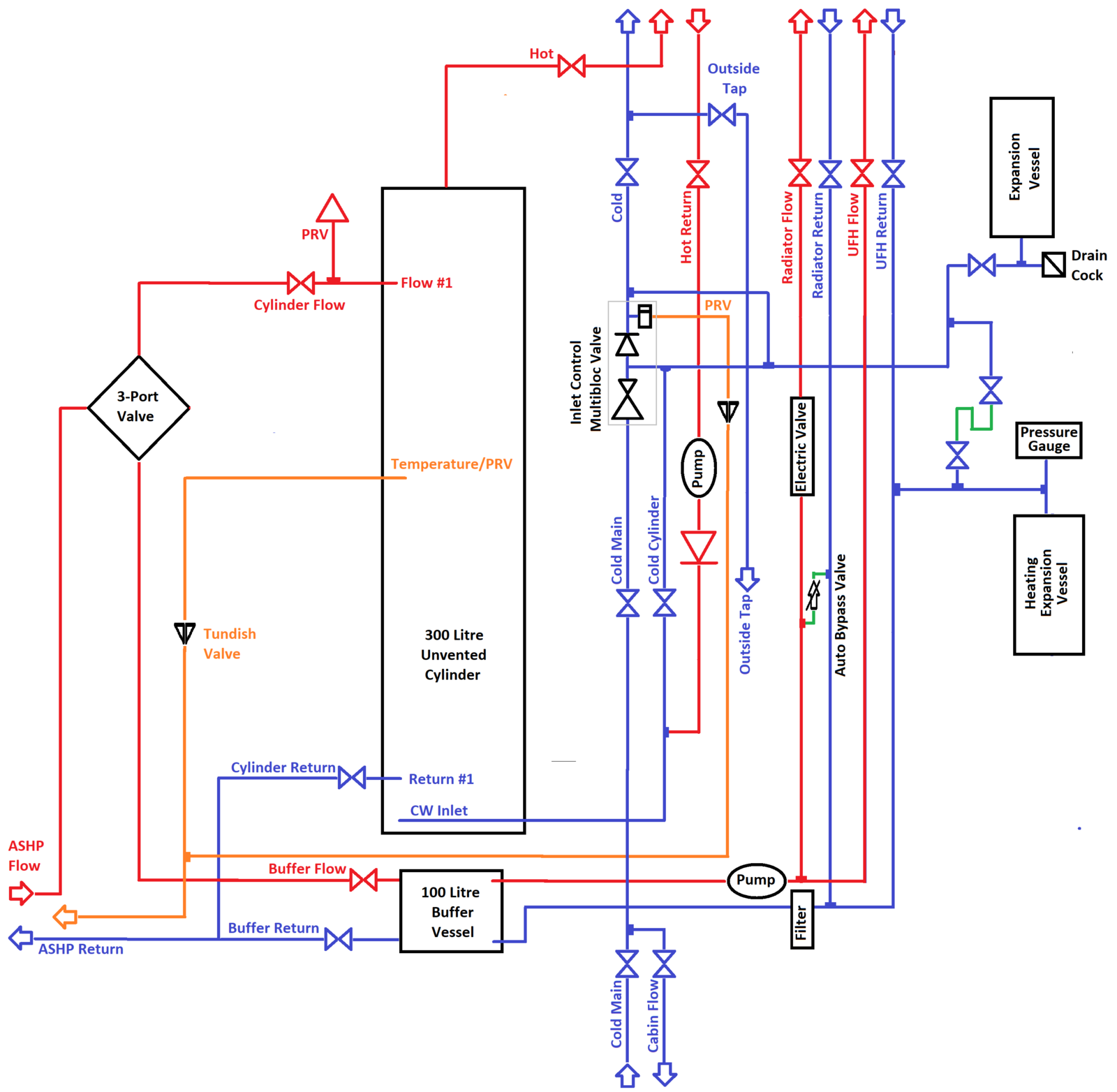

2. My suggested alternative - routes the cold tap to the balanced output of the group valve and the primary output to the cold cylinder input and removes the odd link from the primary output back to the balanced output.

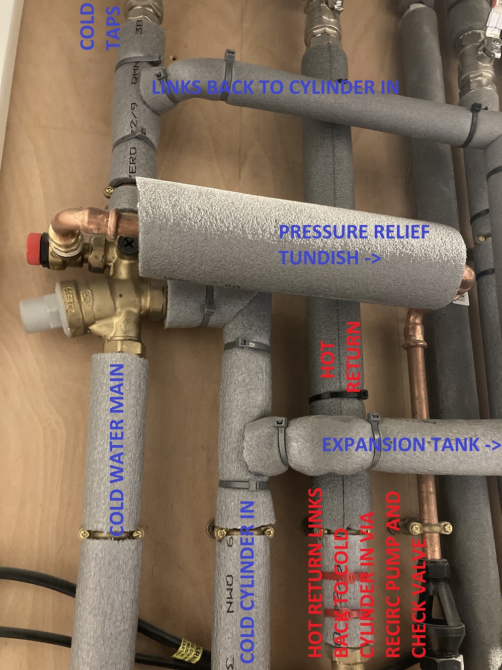

3. A picture of the actual group valve and labelled pipework.

Just to close this off, the engineer visited today and confirmed that there was an error in the installation: the pipework to the balanced takeoff should have been routed to the primary output (incorporating a check valve) and the pipework to the primary output should have been routed to the balanced takeoff. He came up with the same solution as I did - a check valve in the feed to the cylinder as an alternative to re-routing a load of pipework. Haven't tested thoroughly yet but it does seem like the cold taps I've tried are already noticeable colder.

Make sure you don’t put the check valve in between the cylinder and expansion it really needs to be re pipe correctly.
Thanks - I did say this to them but I'm arranging a service of the system with the installers and will hopefully have everything resolved at that point. For now though, at least we haven't got warm water from the cylinder entering the cold water supply but I'm a bit concerned about the potential 4% water expansion.
