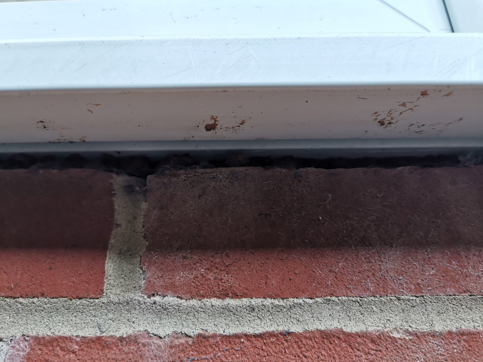

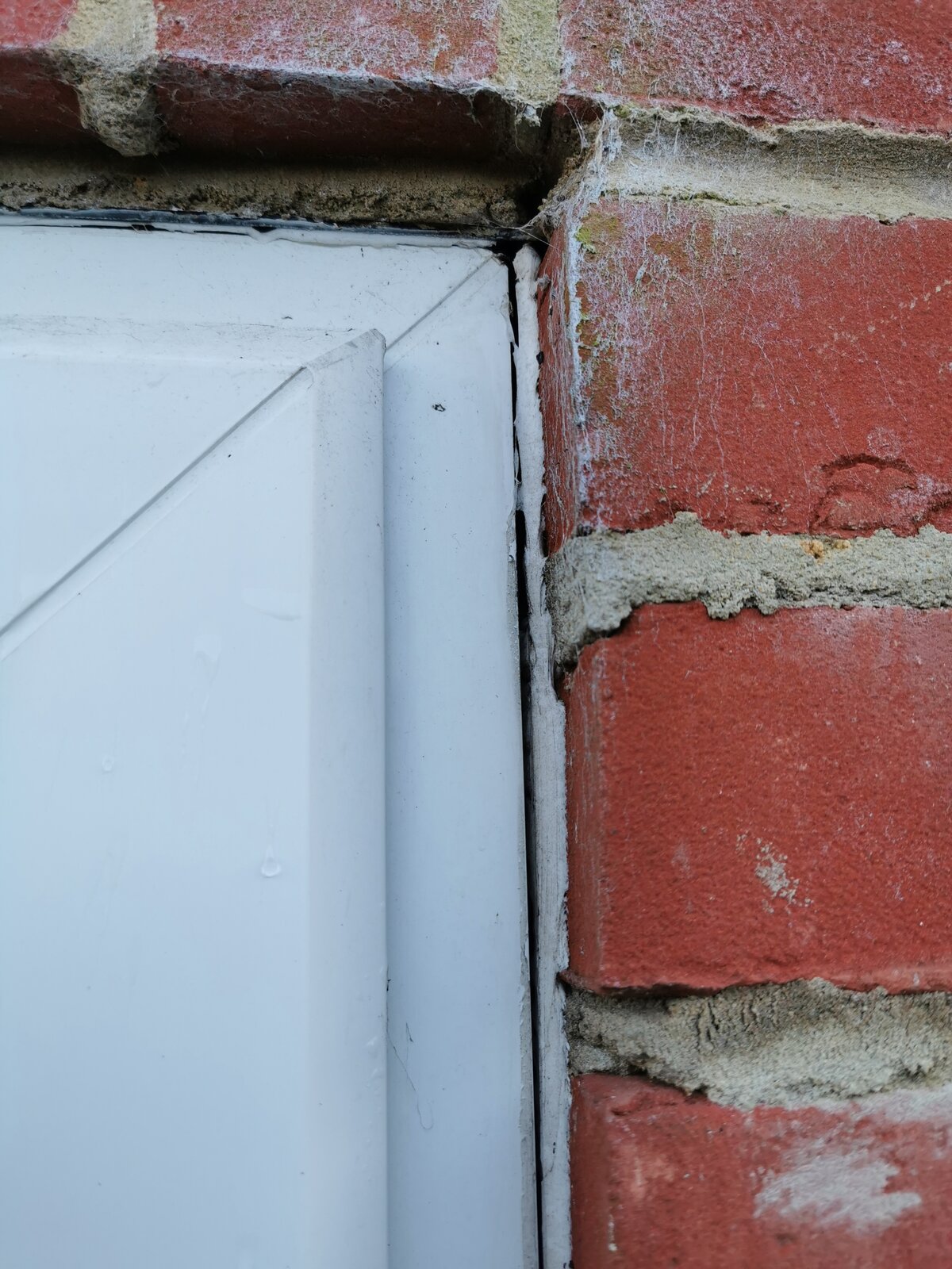

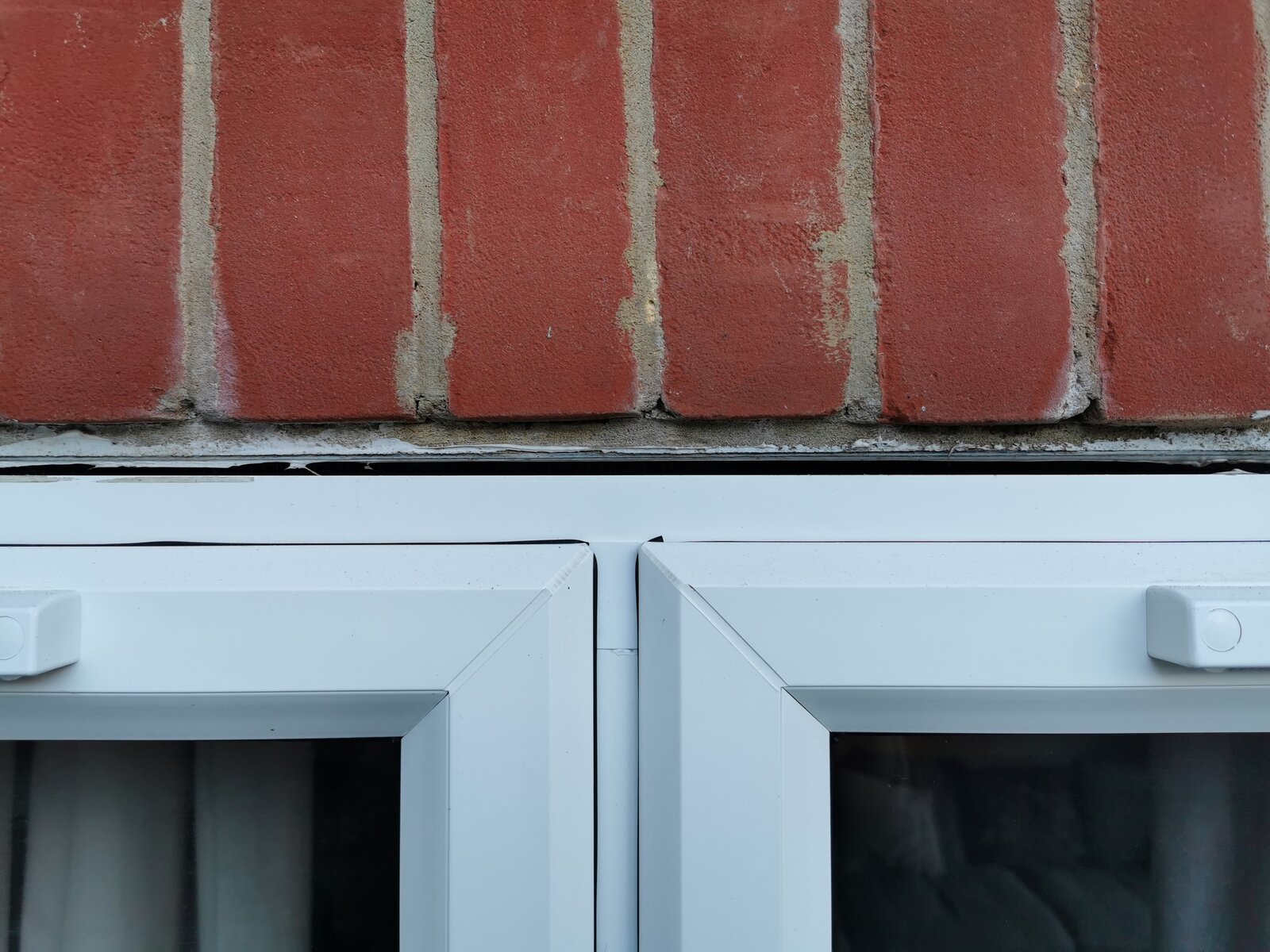

Did anyone have any thoughts about the gaps above and below the outside of the windows in the photos I linked to? Adding them to this message for reference. Could they cause draughts that go through the walls somehow? What would be the best thing to fill the larger holes with? Expanding foam?

Whether the heat emitter is sized correctly is more about working out if it can replace the heat escaping, rather than it heating up quickly. There are various calculators online.
The other issues are whether its a perception of coldness due to draughts or air currents (radiator positions drawing air across a room) or whether the room is better served by more than one radiator suitably sited to heat the room evenly
If the rest of the house is warm, then that normally indicates an issue with the heating of the room, not the room structure
