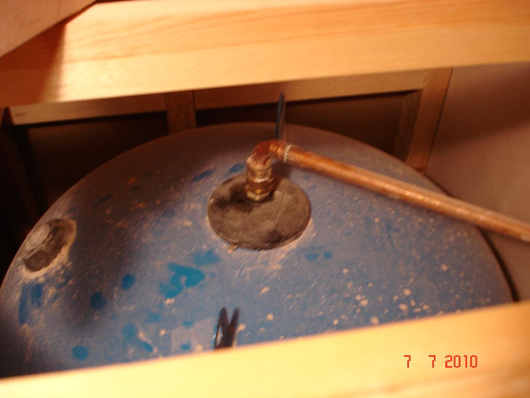

This is very interesting info. What we can perhaps establish, then, given it has worked fine over a three year period at ours, is that an Altecnic (its an Ultra Pro 300) will dispense the water out of the top end - even when it is not intended to be done that way :)
Here's a photo:
http://www.stelma.org.uk/DSC01522.JPG
Yes, having a pressure gauge in the top connection instead of the outlet would make a lot of sense. I wonder, then, whether we have gotten poorer performance from the vessel as a result of how it was connected, and as Steve suggests this may explain the black residue. I also wonder how many Altecnics are installed incorrectly up and down the country. When we got ours there were no instructions as to how it should be connected as an accumulator.

i have the mi's for a gah dualstream on pdf if you put your e-mail in my profile i'll e-mail them they show an accumulator with an un-vented cylinder the connections are the same for all accumulators it,s best to connect them in 22mm as far as possible even if the incoming mains is only 15mm if used on a combi.

Here is the photo Steve,
I have put my email into your profile. It would be great to receive this - it would be god to get the install of the new coldstream right.
