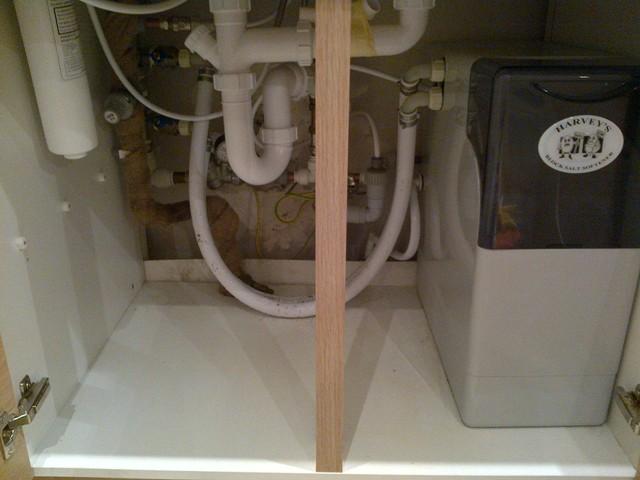

Hi all, after some practical experience from anyone who's experienced this. I have some fairly severe problems with the cold water pipe condensation under my sink dripping water all over the place. The house is new build (within the last 12 months) and faces onto the open Countryside so is fairly exposed to the elements (the kitchen is on this side as well).
So a few mistakes that have made the issue worse have been leaving too much cleaning crap under there preventing air flow - these have now been removed. Worse still is there's a water softener installed under there so aside from the extra piping, the system flushes through about 17 litres of cold water every few days when it cycles.
There's absolutely no lagging installed so I was considering buying some wrap around foam insulation stuff like THIS and seal every pipe - right after I clean up the mould.
So a few thoughts..
1. Do you consider it'll be sufficient to stop the problem?
2. This foam stuff is not going to be any good at insulating the flexible piping - is there another product you've used or can recommend?
3. I've considered blowing foam insulation behind the kitchen cabinets but I know this is bad for airflow - I still question whether it may be a better thing to do?
Let me know your thoughts!

Insulation should help by virtue of it reducing the opportunity for interfacing between the cold pipes and the surrounding air, however you should ought look at where all this damp air is coming from as in an otherwise 'dry' kitchen you should not be getting all that much condensation anyway.
Do you have an extractor fan/hood, and is it used?

It's definitely not damp. Purely condensation forming and running off the pipes. Where we live the water coming into the house is very very cold and being a new build is quite well insulated. Having a young infant at home, we generally keep the house warmer than normal (22 degrees) so despite having/using the appropriate vents and extractor fans the issue is still prevalent due to the temperature variance.

Another point worth mentioning however is this is the location the main external pipe and stopcock.

Condensation does not occur merely due to temperature differentials - the air has to contain the water vapour in order to condense and whilst the incoming water may be cold it is no colder than anyone else's.
The dew point of air at 22C and 5C is however different and so some level of condensation is to be expected but the fact that yours is of a sufficient level to cause an issue suggests to me that you have too high a level of vapour in the air and so whilst insulation might help in this cupboard you may find you are merely pushing the problem elsewhere if you don't tackle the source.

That's really helpful. Thanks. So I'll really need to consider how to further reduce the humidity in addition to any insulation.
Ok. Some interesting additional observations from today. Turns out there's a heck of a lot of condensing going on on the exterior of the water softener. Air humidity aside.. as I'll attempt to do something about that as well, but can anyone recommend an effective method for insulating a water softener?
Get some expanded polystyrene slabs from a diy store - make a box to fit over the unit . Stick the slabs together with decorators caulk and hold together with duct tape ;) The lid can be left loose

Thanks Nige. Interesting idea although might be a bit of a squeeze you think given the small area (have a look below)?
I've just finished cleaning out the whole area so everything is clean and dry for the moment. Have raised the softener off the cabinet base with some supports to allow additional airflow.
Here's a snap of the area before I cleaned it up.
I reckon a few other things I need to do is cut away some of that carcase base so it's not tight up against the pipe and shorten the softener pipes - I don't really understand why they were installed that long in the first place!
