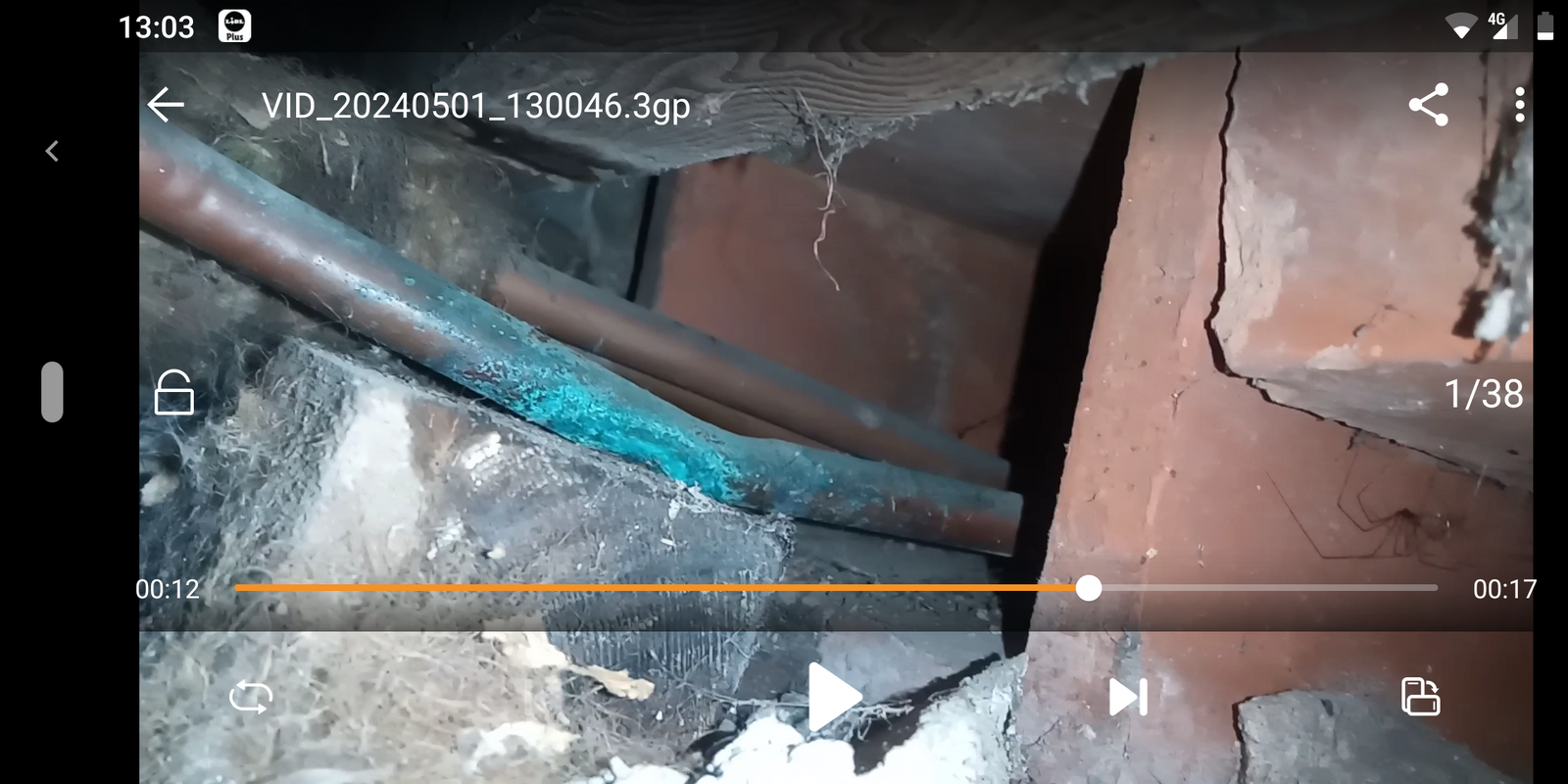

Just to complete the thread.
Got the insurers in for trace and access.
Slow leak found under kitchen sink, next to outside wall.
Gonna need to pull out the unit under the sink and pull up floorboards - but at least it's not pulling up laminate and hacking into concrete.
Thanks for responses.
