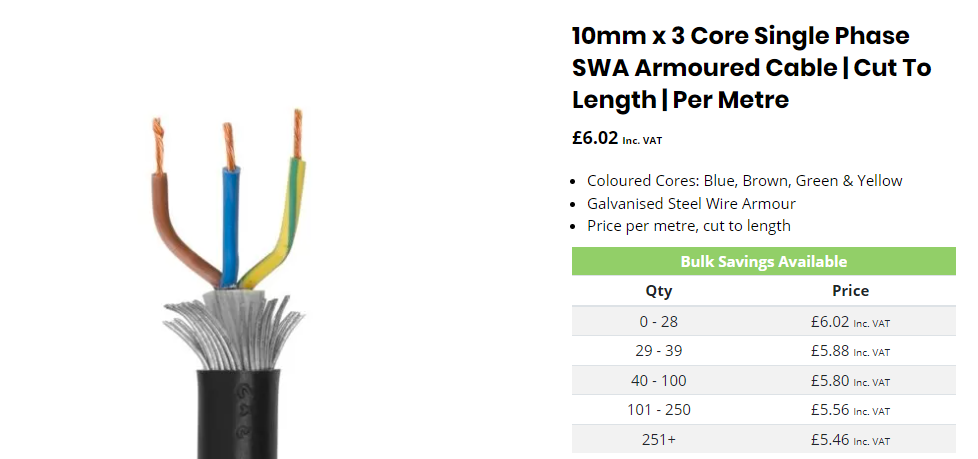

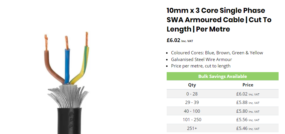

TBH I dont remember seeing G or G/Y conductors in SWA but that doesn`t mean it did not exist, plus I suppose a manufacturer would make you some if you paid for it
I don't think he was denying its existence, just that he hadn't come across it.
I'm sure you're right but, as I said, I was making the point that Mr Google found countless examples (one of which I illustrated), suggesting that it's pretty widely available, even if he had never seen it.
