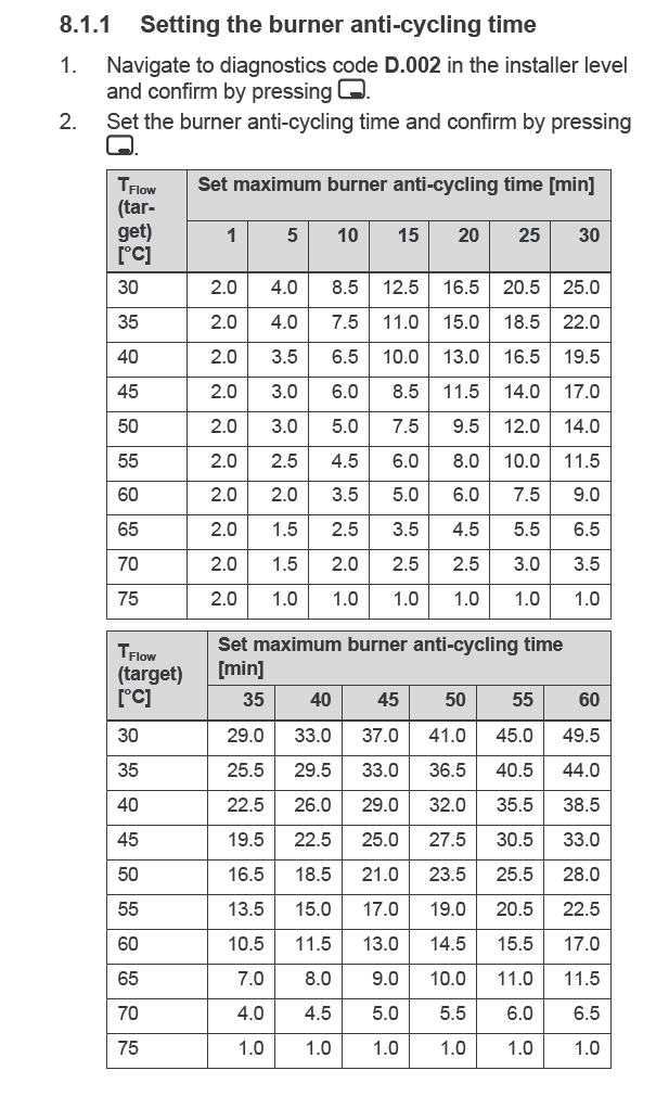

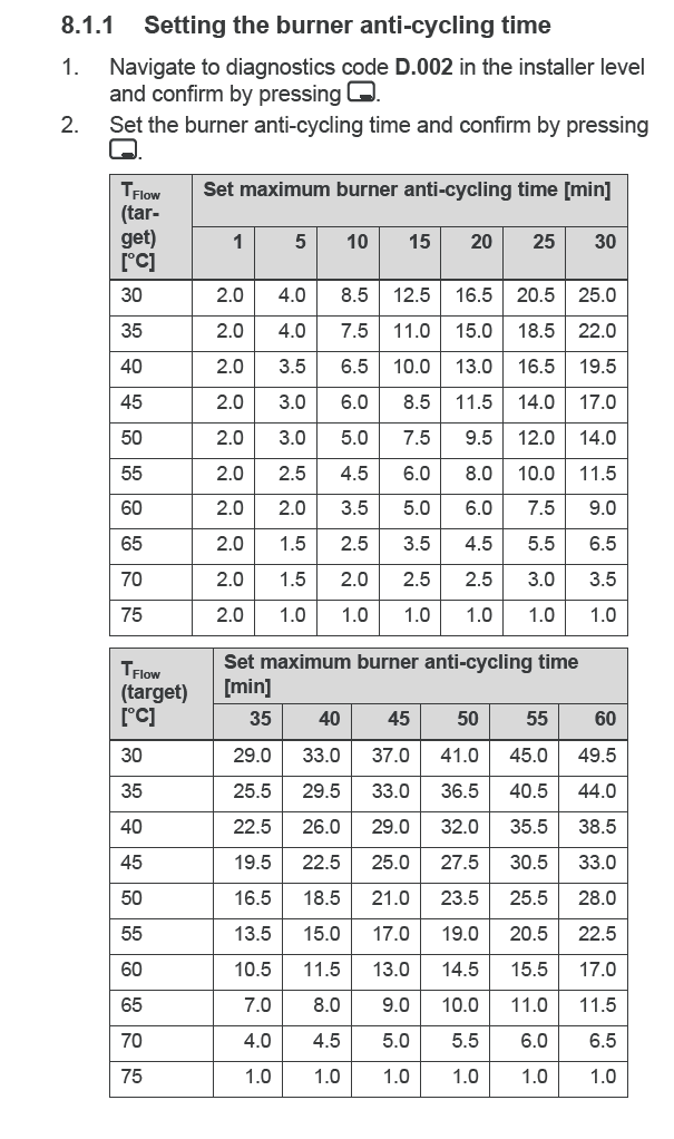

You should check the anti cycling time, this normally defaults to 20Minutes but the actual recycle time is a look up table using the set time and the target flow temp, see below. if the set time is 20 minutes (at 65C target temp) then the actual anticycle time is 4.5 minutes, would suggest setting it to 40 minutes this will give a actual anticycling time of 8 minutes which is just 2 mins less than the 6 CPH (10 minutes), you can set it longer but it will then eat into the cycle off time remaining, if you sret CPH to 3 then you can extend the anticycle time to 18 minutes or so if required to enable the boiler to fire up at ignition conditions.
