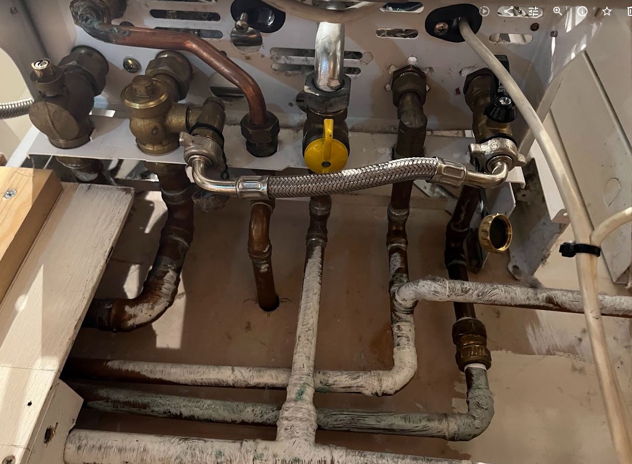

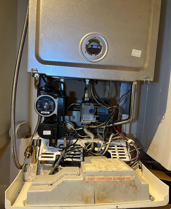

So the boiler is a Vokera Linea 28 - according to the manual, there should be a condensate trap/pipe installed, however, I can't see where this is or indeed if one is actually installed.
Look for a white plastic pipe connected to the boiler ,or show us pics of pipework entering boiler.
The only white plastic pipe appears to be on the first pic and goes into the area of the Gas valve
That's a non condensing version. How old is that boiler ?

Thanks - it's about 20 years old - there are radiator pipes under the floor voids, however, pressure is lost even when I isolate the flow and return CH valves. This is why I'm suspecting that one or both of these valves is not sealing and hence even when the boiler is isolated, pressure is being lost through radiator pipes overnight.
That said, when the boiler is running, no pressure is lost - when boiler is off, pressure drops (from 2 bar to 0 bar within an hour), so any leak must be quite significant and I'd therefore expect to lose pressure even when the boiler is running but it doesn't.
Pressure would be lost when boiler is isolated,as the loss is on the system side. If it's under flooring ,is there a deep void below ?
