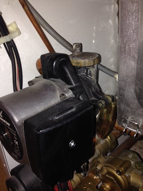

Hi, bringing this thread up as about to change seals on the diverter valve and noticed the black schrader valve dust cap
like a car valve was leaking after running the hot water tap. Is this a auto vent for the pump? Looks like it has been leaking for a while but as I said we have not long moved in to the house.
Should this be tight or backed off? Starting to think the 15 year boiler could do with a proper service as mention in the previous post the boiler does lose pressure when hot water is run.
That is not a shraeder valve and yes it is an automatic air valve, usually draining the boiler and cleaning them stops them from passing they have a small float operated valve inside them and are supposed to let air out and then seal but they leak all the time , as a temp measure just screw the black cap down and if you need to release air at any time before you sort it just unscrew it again till the air is released
