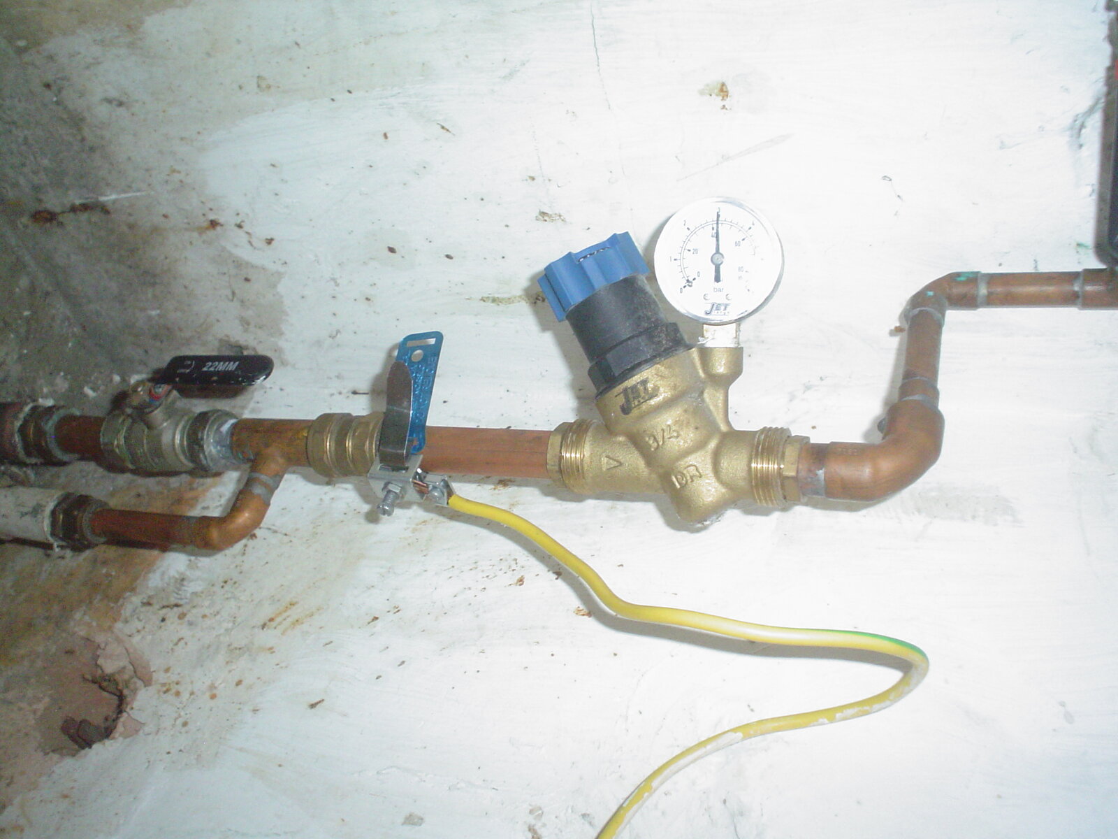

I have a Vallaint eco-Tec plus 832. When the boiler was fitted five years ago, the engineer put a pressure valve on the mains and set it to 3 bar. That would be OK but the pipe for the boiler is taken off from the pipe which goes upstairs and also to the front hose tap. So what I have is low pressure on one section of the system. Downstairs fine but upstairs low in comparison and the hose pressure is diabolical. My question is, can I turn up the mains pressure to the upstairs and just control the boiler pressure at the boiler itself using the loop. Or is the loop just for central heating and seperate friom the hot water system? He told me that the mains pressure was too high but why would that make any difference? Any suggestions will be gratefully received.

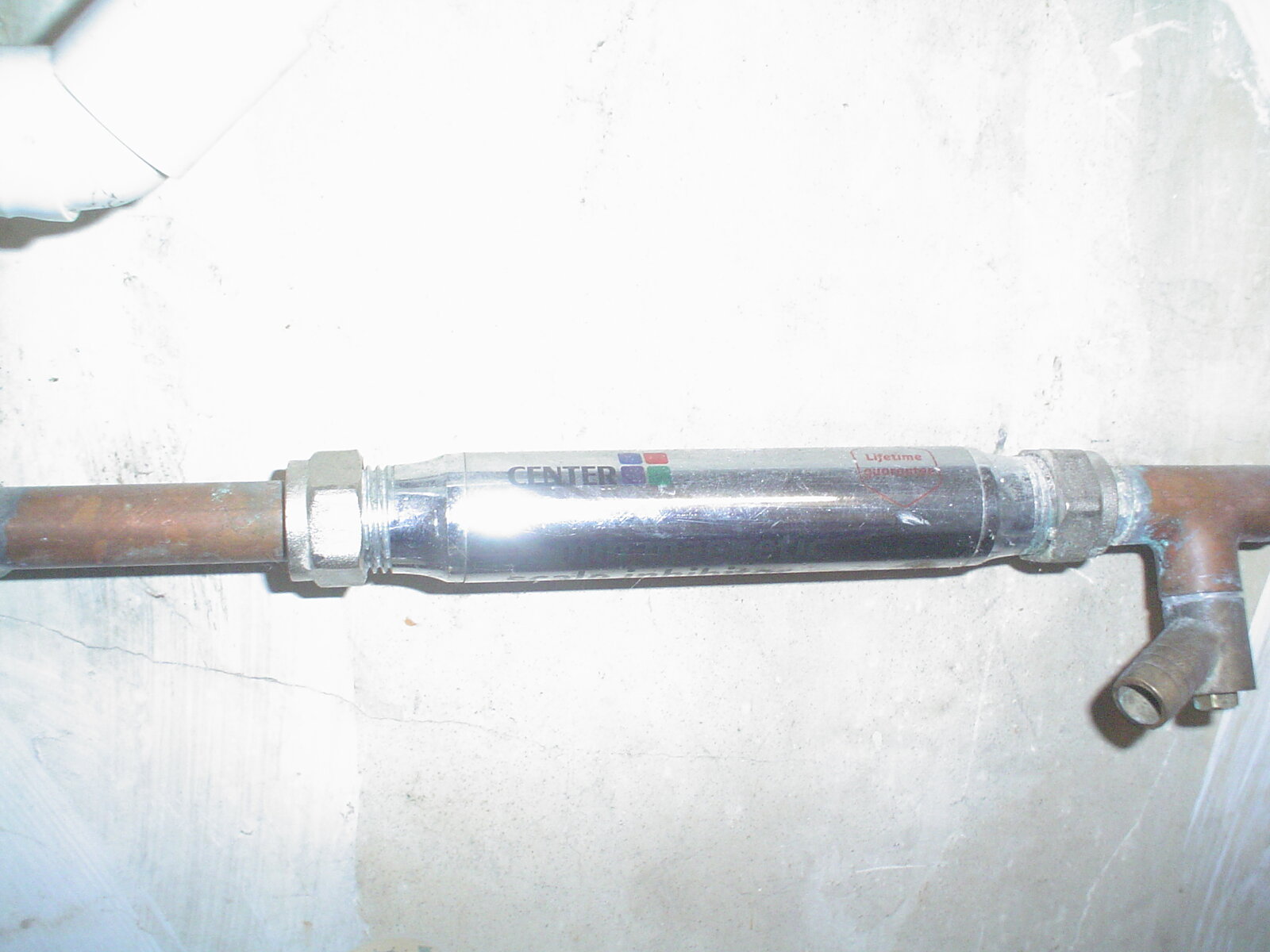

Thanks for your response. As I said, the engineer said it was too high and that was why he fitted the PRV and turned it down to 3 bar which is less than the ground floor cold system. There is a long silver tube with 'centre' written on it so I suppose that's the expansion vessel you mean. So in effect I am adding another PRV and opening up the original one (negating it really) to give the whole house the same pressure and keep the boiler at the 3 bar. I am quite OK with the pressures and heating otherwise, just the cold water for the garden and upstairs really. What do you think?

The PRV was fitted BEFORE the pipe to the boiler and first floor but AFTER the down stairs plumbing. So the downstairs has good pressure only. 3 bars is what the engineer set the pressure to when he fitted it. Cold water to the downstairs is good and the back garden hose is good too. The upstairs and front garden hose fitted AFTER the PRV is crap and always has been that way since the boiler was fitted. I don't know what the downstairs pressure is but it seems to be around 4 bars that's why he reduced it to meet the needs of the boiler. Btw the manual for my boiler states 3 bar max. So half the house has low pressure and one half good pressure.

Post a picture of the mini expansion vessel.

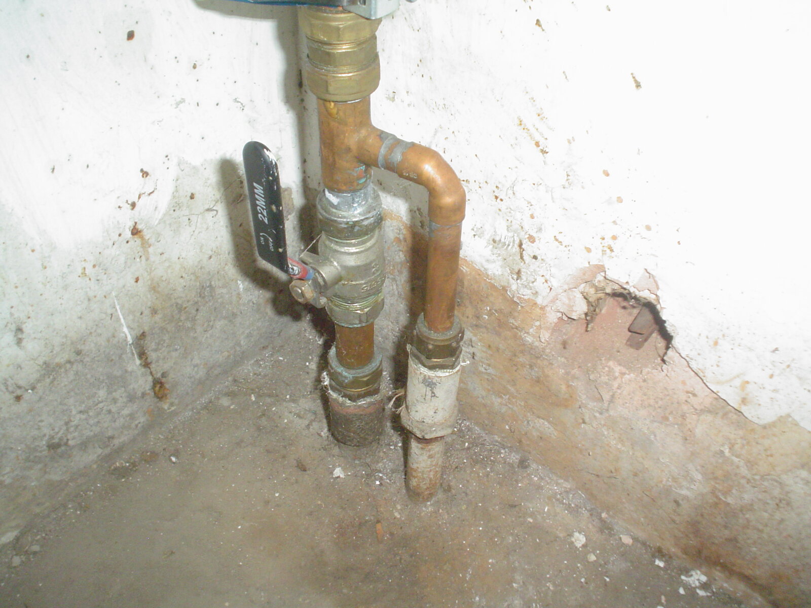

The first image should be vertical. The pipe above the stop cock goes under the floor and supplies to downstairs cold water system.

The silver thing is a scale reducer for the boiler.

Yes it is as it was always 15mm. I tried the upstairs tap when the extension was finished but as I am still working on it I have turned all water off for the time being but I know it is the same pressure as the front tap which as I say is poor. So the circuit is in two sections, the full original pressure downstairs and the rear garden tap and the pressure after the PRV was fitted upstair and the front tap as you can see with the location of the reducer valve. Let me just add that a low pressure in the upstairs bathroom isn't so much of an issue, it's the front tap which is a real pain. It takes ages to water the garden. The downstairs shower is fine too so the boiler is OK. I just need more pressure after the PRV. This is why I am thinking of moving it to the main boiler feed pipe.
Listening to the comments here I think what I might now do is see if I can T off before the PRV to the front tap and leave the rest well alone. It will be a squeeze to get it in but I think I can just about fit a 22 x 22 x 15mm compression. I think it's too risky not being a qualified heating engineer to chance anything Thanks again for all the assistance as it has really helped me come to a decision.
