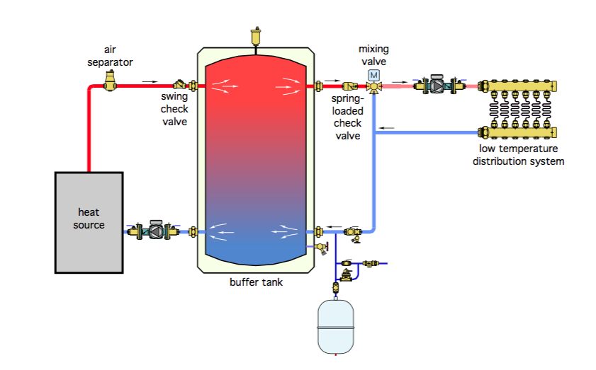

Thanks everyone for the input. Reason for combi is space number 1, the boiler house is small. Secondly we work all day, and don't use that much hot water, so it makes sense to heat water only when we need it. Seems crazy to either store 300L of hot water all day or heat 300L of water for the little use that night.
So a wee buffer tank on the central heating side, will help the boiler heat a larger volume of water I assume than what the UFH has, and help avoid this short cycling.

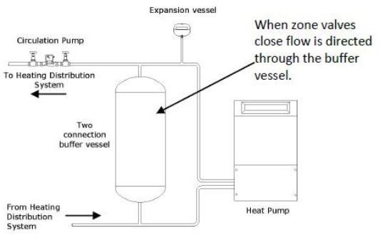

I assume I need something like this.
If you install that contraption you might as well fit a smaller boiler (sized to the heat load) and fit an unvented cylinder.
No. That is a heat pump. The buffee vessel is for different reasons (And the same). Its volume won't do anything meaningful for an oil boiler.
I can find no reference to a buffee vessel on google. Do you have a link to any info. All the info I find online for BUFFER vessel talk about stopping short cycling, for heat pumps etc. Is that not what we are trying to do here?
