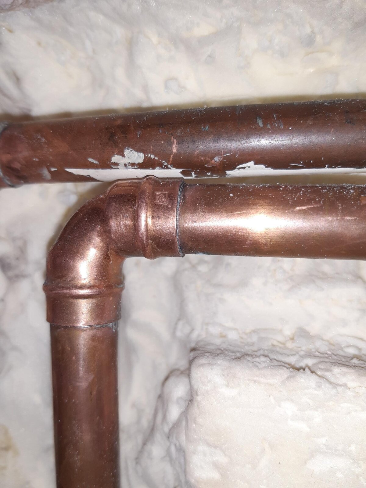

I can hear the groans when I say that the reason I added flux into the fitting was because I followed the advice that I had seen on YouTube!! Anyway, point taken and I won't be doing that again - this is one of my efforts from today - am getting better I think.
