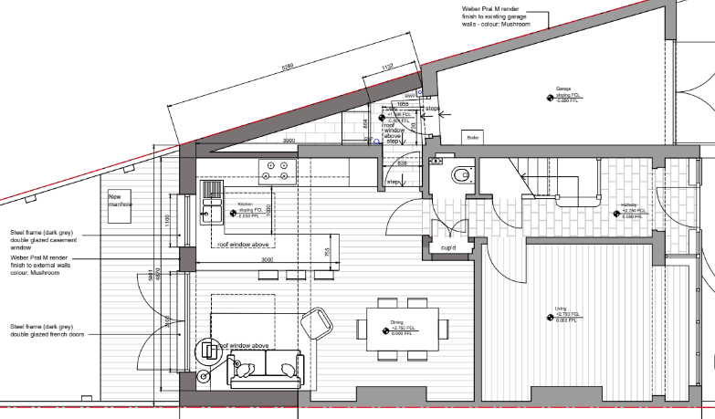

Hoping someone might be able to suggest a practical way forward for our confusing situation.
We've developed drawings for an awkward site that's on a hill with a tapering plot. We want to build a lean-to PD extension at the rear, and join this to an existing garage at the side by building a narrow triangular extension. The triangle and the garage would be given an update with coloured render.
The triangle part of the plans, together with the coloured render, have been approved under planning rights.
We then look to get our PD approved, and were advised by our architect to submit an amendment to the granted planning, which noted the coloured render on this PD rear extension.
The council have said that we can't do both, but the implication is that they would accept a multi-finish combined building - i.e., a PD in white at the rear, with side extension in coloured render.

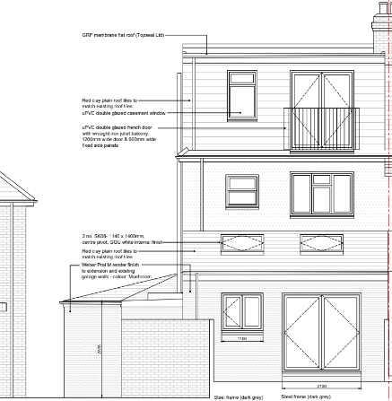

Thank you, Tony. Here are two views; you can see the triangle part (which is, weirdly, approved as a stand-alone development!) and how that fits in to the plot. On the second image, you can see where the neighbouring plot is quite a bit lower- which would mean a rear extension under planning would be really quite tricky. The main house is white painted pebbledash.

So I'm guessing the OP is going to build the rear extension first and then once it's completed build that funny little triangular thing. Otherwise the rear extension aint gonna be PD.
Personally I would reduce the size of the side extension and get rid of the long tapered useless space so it finishes in front of the existing rear wall of the house then both extensions will be PD.
As for the render, coloured render isn't all that dissimilar to painted pebbledash so unless they are going to have sky blue render with pink spots I can't see a problem.

The PD requirements for matching the existing main house are not that materials are the same or even the same colour, but be "of a similar appearance", and further, they do not need to be of similar appearance to the elevation to which the extension is attached.

Because if the little side extension is already there and the PD rear extension touches it then the Planners look at both extensions together. To be PD the rear extension must be completely independent, only on the rear elevation not touching anything else. (over simplified PD rules for clarity so the pedants out there can wind their necks in)
