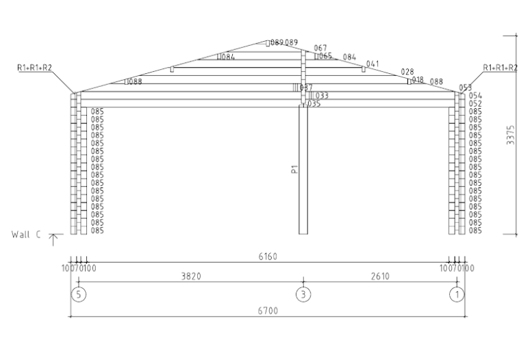

This original design:

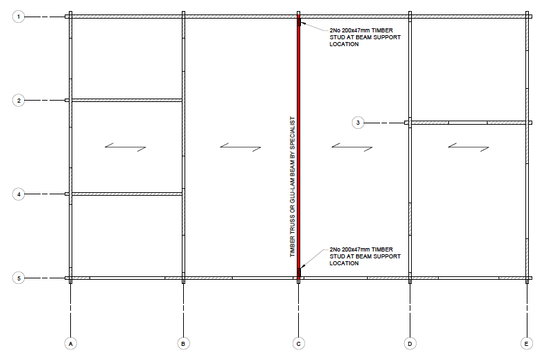

Has us removing post P1and adding the beam, with additional 'cripple beams' supporting each end:

The beam obviously has some loading from the stacked logs above but that will be comparable to the weight of the beam (~200kg?). It is transferring roof load which I have no idea about but I can tell you our calculations show under 25kN load down through the wall at each end, it's one of the few things in the calculations I can understand!
We just got a provisional request for the SE to check 405x90 from one supplier. That's going to eat into head-room a bit, a span table suggests 360x115 would be nearly identical but going beyond 115 wide seems to make less difference. I'd really love if we could get 360 or less.
