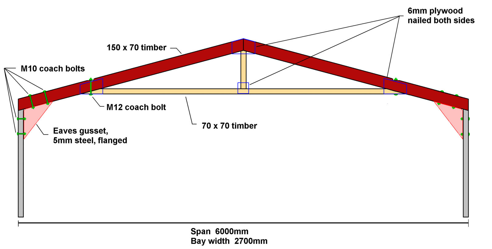

I have a prefabricated timber garage with 6m span and 15 degree pitch roof. There is one truss mid-way along the 5.4 building, so the bay length is effectively 2.7m. The dimensions are roughly equivalent to those of the OP's building.
The truss is a very simple design, using 150x70 timber for the top chord (sloping rafter) and 70x70 timber for the bottom chord (horizontal tie) and kingpost. The top and bottom chords are connected by M12 coach bolts. There are steel eaves gussets made from 5mm thick plate, with flanges for bolting to the top chords and the wall frame. The bottom chord is raised above eaves height, therefore headroom is excellent over most of the building width (obviously some restriction at the eaves gussets).
This must have been very cheap to produce, in fact it would have been an easy DIY job. I have no idea who specified and/or approved the truss design, and all I can say is that is hasn't shown any signs of failure to date.
