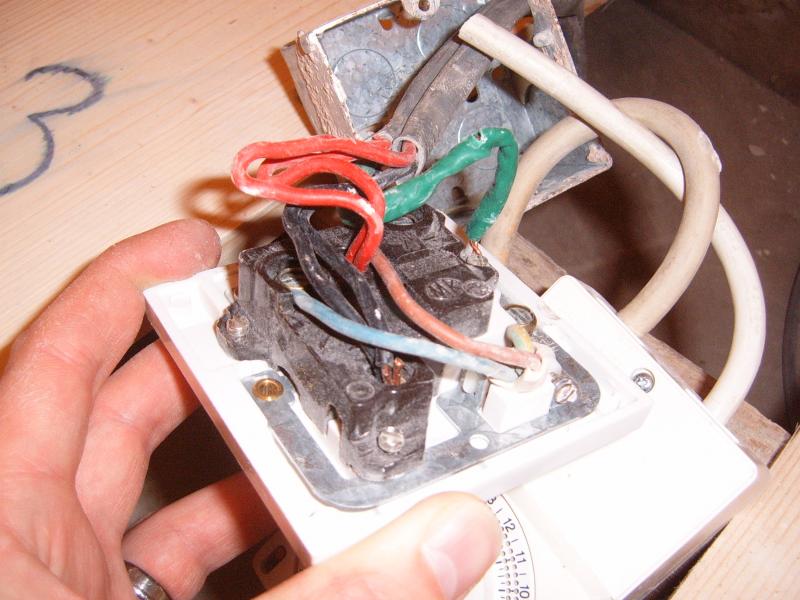

Hopefully this shows everything clearly?
The two thick grey cables feed into the switch and the wires are secured into various positions on the switch (one cable has a red and a black wire coming out, the other has a red, black and green wire).
There is another thick white cable between the switch and a timer switch, which would have then gone into the water tank (this was cut when the tank was removed - you can see the end cut). Three wires come out of the white cable and are also secured within the switch.
Are you sure that the earth conductor from each cable doesn't go through the same bit of green sleeving?
You need to check, because if it's just been cut back in one of the cables you could have a problem.
Also you need to trace the cables to find out if what you have is a spur from a ring final which then has another spur from it, which is wrong, or if it's connected directly onto a ring or radial, which is OK. (Not that the immersion heater should ever have been on a socket circuit in the first place, but it wouldn't be the first time...)

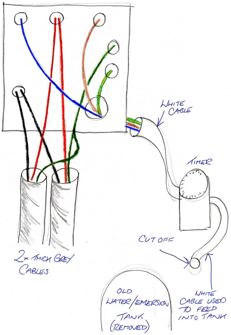

Hopefully these diagrams show exactly what the set-up is. You can see the set-up I now have under my floor boards.
Now the water/emersion tank has gone I was hoping I could remove the timer all together, then connect both the red, black and green wires; this would complete the circuit?

Yes - you could join the cables inside the back box and put a blanking plate over it, and that would complete the circuit.
The trouble is we still don't know what that circuit is, and what else it supplies and how, so there might be other changes you should be making to it.
