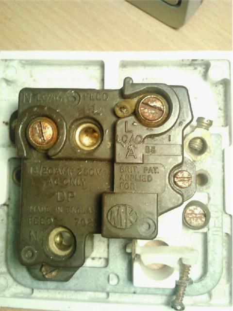

Thanks to everyone for your advice, and oharaf for your extensive post - I appreciate it. On the subject of a 20A FCU - I've dug up an MK FCU in the garage which says 13/20AMP 250V on it - does this mean that this FCU will accept a 13A or 20A fuse - or does it mean something else? I've attached a photo of it just in case it clears anything up.

Don't know what the 20A is referring to on the FCU, the biggest BS1392 fuse available is a 13A
