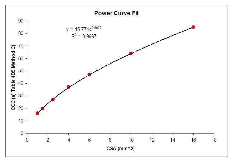

Are the cable ratings calculated accurately?
Clipped direct, 1 milli is rated at 16A, 1.5 is 20.
16 x 2.5 = 40
20 x 1.6r= 33.3r
I know one cannot extrapolate the figures for larger sizes as it is not as simple as that, but there does seem to be a huge margin of error built-in.
Are the cable ratings calculated accurately? Clipped direct, 1 milli is rated at 16A, 1.5 is 20. ... 16 x 2.5 = 40 ... 20 x 1.6r= 33.3r ... I know one cannot extrapolate the figures for larger sizes as it is not as simple as that, but there does seem to be a huge margin of error built-in.
There undoubtedly is a large safety margin built in to the figures we use, but that's a different matter. As you say, it's not 'simple'. Current carrying capacity is not linearly related to CSA - on the basis of the physics, one would probably expect it to be more closely related to the ratio of CSA to surface area. As I've illustrated before the relationship between BS7671 CCCs and CSA is almost exactly a power curve, CCC not being linearly related to CSA but, rather, related to CSA to the power 0.6077 ....
