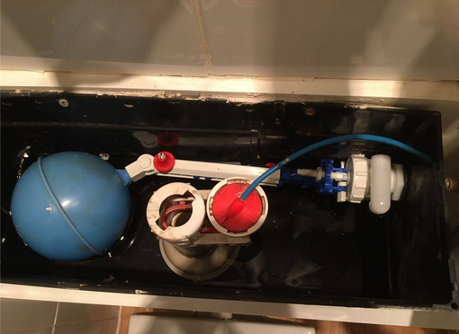

Concealed cistern slow to fill
There is no brass lol. It's all plastic and my kneecap is knackered already :D:D
This is what I currently have
The plastic screw with the locknut is adjusted to press correctly on the pin. Undo the locknut and screw the plastic bolt towards the valve to close the valve at a lower water level.
Aha so sorry....just follow footprints advice above and all will be well.
10mm spanner and maybe a pair of snipe nose pliers may help.
