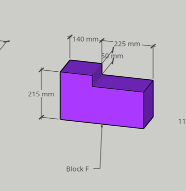

Just a quick update. I used a hammer and bolster to cut a few blocks yesterday and all went well. Taking a little longer than I first thought but I haven't broken one yet. I will need a grinder for some though as I need to cut a notch section (see below):
Jeez! I could buy three 9" Makita angle grinders for that!

Having had success with the hammer and bolster I now realise I need cut a lot more blocks and also slithers too so I think I may need a angle grinder/disc cutter. I've had a look at the evolution disc cutter above and I also saw that people were mentioning 9inch cutters from Makita and Dewalt. I will be cutting 140mm dense concrete block and also in the future I will need to cut Indian sandstone paving slabs too.
Would I be best to go for the cheaper Makita/Dewalt grinders with a diamond blade or just go for the evolution 300mm?
Any advice appreciated.
