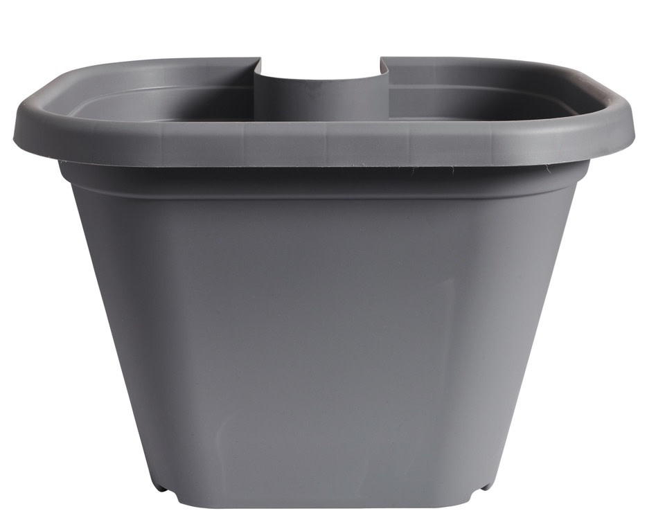

Strategically place some pots around them if they're so offensive. You can then grow something up it/them as well.
Pair of these back to back might fit?
