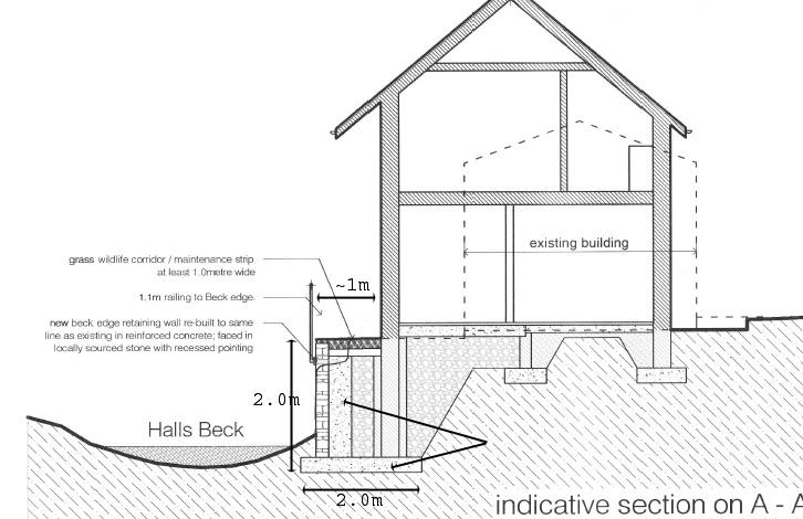

I have a 33m long by 2m high reinforced concrete retaining wall to build along a riverbank which will then be stone faced. I have two solutions from the structural engineer 1) hire in shuttering and pour the concrete 2) build a 150mm cavity block wall and fill that with concrete both will have a steel reinforcing skeleton designed by him. anyone been through this scenario before and how did it work out

the river is really a stream and at this time of year only about 20cm deep about 3m wide but can flash flood. We have to build a coffer dam (just sandbags) to keep the footing dry, the foundations are to be excavated below stream level and the base 200 to 300mm deep about 1.5 m wide. I intend to do the wall in 3 sections each 11m long. In non flood conditions the base of the existing wall is above stream level up a short bank, in flood conditions or heavy rain the level will reach the wall bottom, the wall has to be removed to build the new reinforced retaining wall.

Gabions are used on the stream in places to stop erosion, they have been ruled out here, once the retaining wall is up foundations for a new hose will be built, the reinforced concrete is the solution agreed by 2 different structural engineers. My question is shuttering or build a block cavity and fill, farmers or ground blocks again have been ruled out as a solid concrete core is required. The existing wall is in poor nick but is not bulging showing the ground to be stable. We could use piles for the house and just tart up the wall but the concrete route seems the most complete to make a good job. Shuttering sounds easy but I sort of prefer the filled block wall for no other reason than that's what i'm used to...any thoughts

Go along with the 1.5m width founds and I would like to see 600mm dig below present water level with 400mm reinforced concrete across the width to stop er breaking er back
I know you have said that she is to be stone faced, but an over all thickness of 350mm by 2.0 metre high worries me. (Have I read the thickness correct?). Would have liked to have seen more meat down bottom, but then again do not know what or how SE has drawn up steel. Can only guess at what he has done.

Thanks oldun for such a comprehensive reply, especially since you didn't have all the info. We have certain things forced on us by the Environment agency (coffer dam) but we also have some things going in our favour (hopefully). The drawing shows the section, the existing building is a large steel shed with minimal founds but the whole site appears stable and has been like this for many years (the building 20+yrs) also part of the stream shows outcrops of bedrock which we may or may not find. A lot of what you say is broadly in line with our plans and I'm glad you agree with the filled cavity option, we were going to run 4 courses let set for a couple of days then fill and tamp but not vibrate as this may break the wall apart. The SE feels the reinforced wall is mainly to protect from erosion in flood conditions rather than holding up the site. Once the wall is up the site should be able to be developed as a normal site although as you can see the front foundation wall will go right down onto the reinforced base and this will be layflat block upto ground. I am planning to go in with a smaller digger (at least for the first 11m) as it will be exploratory and we will see what we find. Also the operator already has done some digging on this site before and thinks it can be done by going down in a terrace much as you suggest.

Static. How will a pure RC wall last longer than a filled cavity. The pure RC was going to be 200mm thick compared to 150mm cavity but the cavity RC will be sandwiched between two 100mm block walls with lots of wall ties. The steel skeleton will be much the same whichever method. Also the idea of maintenance is a heart stopper! this is intended to be a whole life solution with the only exception being the stone facing which would be the case whichever method is used. It would be possible to fill the 650mm gap between the back of the RC wall and the layflat house foundation wall with concrete and even another skeleton but this is felt by the SE to be unnecessary and can be filled with loose stone/hard core keeping the costs down. What do you think??
Pure RC wall could have a design life of 120 may 150 years.. whereas the cavity wall tend by nature to have less cover to reinforcement thus can never achieve a 120 year lifespan, so may need replacing every 60 odd years.. most of this may seem like crazy talk and nothing to worry about but part of my job is to consider what your great grandkids are gonna have to do ;)..

Static, I believe the only stupid question is the one you don't ask so here goes.. are you sure you are looking at the sketch correctly? the only way to do maintenance to the block wall will be to excavate out the loose fill down to the base (~1.6m) thereby opening up a 650mm cavity on the house side, and on the stream side taking down an~300mm solid stone facing wall, doing a spot of pointing and then rebuilding everything!! and this every 20 years. The only frost damage should be to the outer stone wall which I agree will need pointing every 20 or so years. Everything else is buried as an integral part of the overall foundation. Also the longevity of the wall, maybe I should increase the cavity from 150mm to 200mm which will then match the pure RC spec, the blockwork then becomes simply a shuttering system and if it crumbles at all then so what, one side becomes part of the loose fill and the other just a bit of wall rubble. I'd be happy to do this little bit extra (~2.5 cu m of readymix) if it going to double the life of the wall. or am I missing something?

Okay Tul, Get back to post now. As said, sight of a comic is worth a 1000 words, but still very much to the imagination. At least puts me mind to rest about extra meat at bottom of wall. House founds lock all together.
Imagination, such as, what is length of present retaining wall, where does this fit into the equation of the new 33m wall? Why do you want a 33m wall for single unit.? Depth of house as shown about 4.7m. To pitch stairs from river front to first floor back wall and back corridor, with say 4 beds and bathroom, you are looking for about 14m in length. Once again what is rest of wall retaining?
