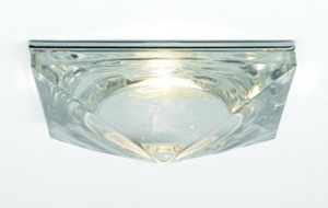

Yeah the instructions do say to ensure gaps in ceilings are well sealed. The lights all have a rubber gasket, but I don’t know how I’d seal them any better than that. Is there a reversible (ie not gluing) way of doing this?
There are products available to seal spotlights, usually to provide fire resistance. There's an example here.
Personally I fitted lights that have a sealed glass cover.
You could buy a bunch of smoke hoods at modest cost. You can put insulation on top of them if you have LEDs, they do not get very hot.
The fire resisting ones are preferable, I can't find any economy ones today
It's possible to make open-ended cubes out of plasterboard if you have it to hand.
