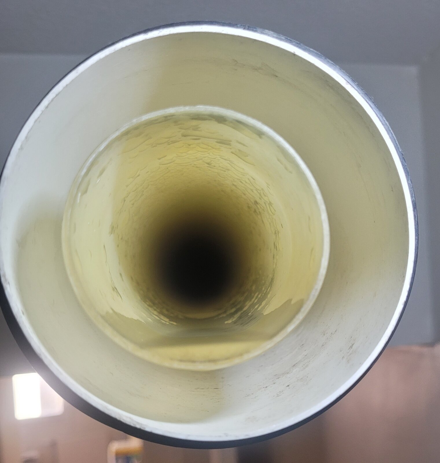

Plumbers that came to check thought the water was coming from the air intake on top of the boiler, because of a possible leak with the inner fumes exhaust pipe.
One used a probe to measure the composition of the air intake (the front panel was ofc closed). No CO was found and O2 was at 20.9% which seems to indicate that no fumes were leaking into the air intake pipe. The pipe was also unmount and no water was found in the outer section (see attached photo).
Also, the condensate drain was tested and no problem was noticed.

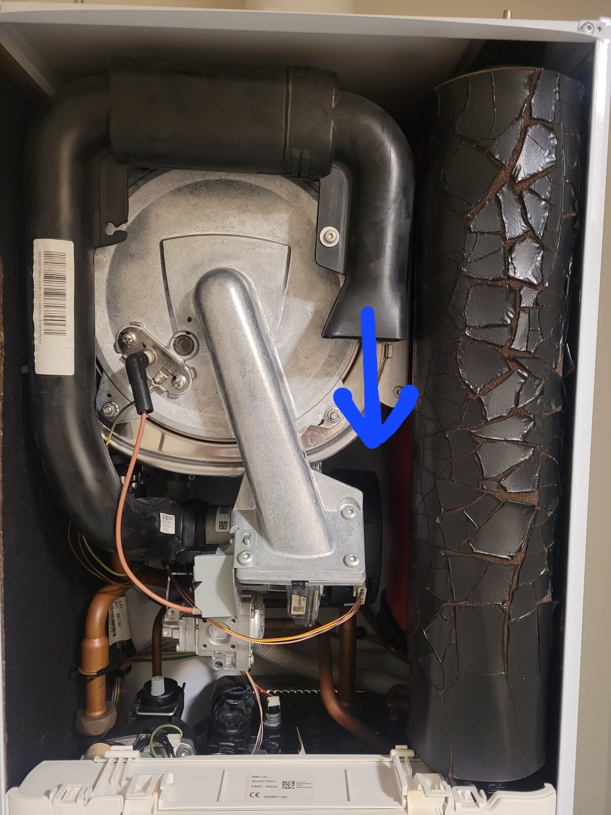

After more investigations I found out water in the air entry before the gaz mecanism and the extracting fan. The air was humid and warm, even hours after use of the boiler (I only use it to get hot water for showers). The water was found inside the black tube where I added a blue arrow in the attached photo.
I have measured very high levels of humidity in that tube (90% RH) and high temperature (30°C when the room is at 18°C).
Also there is a smell of gas coming out from that black tube just after the boiler shuts down. Sometimes some CO (up to 60ppm) come out from the tube, also just after shut down, and then nothing but humidity. One plumber told me it was normal as some unburned gas could leave the combustion chamber after the fan stops. Moreover, I wasn't supposed to smell it because the front pannel should be closed.
Could you help me with that issue ? Could you confirm that it's not normal that some moisture come out from the blue arrow ?
When the fan stops, is there some mecanism that should prevent moisture to come out ?
I thought that maybe the fumes we not evacuating correctly and stagnating inside the combustion chamber before eventually leaking. But I can see fumes leaving at the end of the flues.

So I would assume the origin of condensation is combustion gasses. The weird thing is that plumbers / gas operatives did look for CO outside (near the flue) and inside the boiler. Nothing was found when the boiler is operating. However there is CO coming out of the silencer (what I was referring as the "black tube" in my first post) few seconds or even minutes after the boiler has stopped. And then condensation appears inside the silencer.
Do you believe it is a problem with the flue, even if combustion gasses would be leaking from the silencer ?
As the air intake (silencer) is directly connected to the combustion chamber (CC) through the burner and then fan, then it's conceivable that air is being drawn in through the flue and then through and drawn out through the air intake. That would need a pressure differential between the flue and the case allowing some 'reverse' circulation of air back down the flue, through the CC , past the fan and out the silencer.
1 good reason why not to keep the room sealed case off the boiler, if CO is emerging from the silencer therefore it's getting into the room
So there is a depression in the case ? Could it also be the flue that is partially clogged ?
